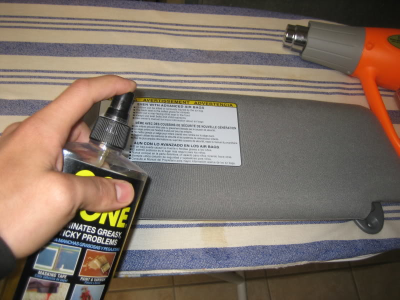

    I hate those bright yellow and white stickers on the visors so I removed them. The 2009 visors are very easy to remove. It has 2 screws on the outer plate.
    First spray it with Goo Gone:

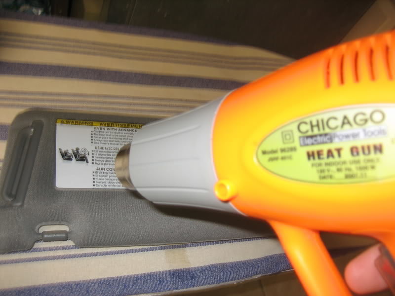

    Apply heat with heat gun:

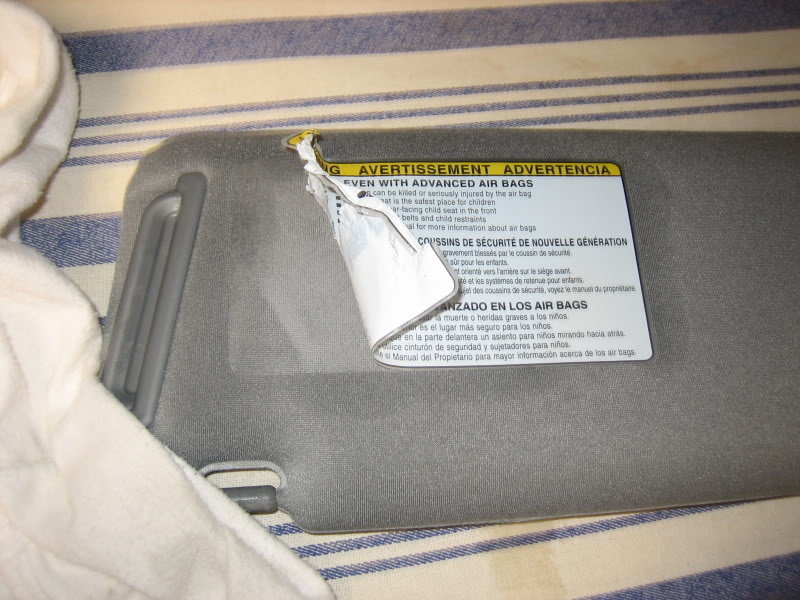

    And peel:

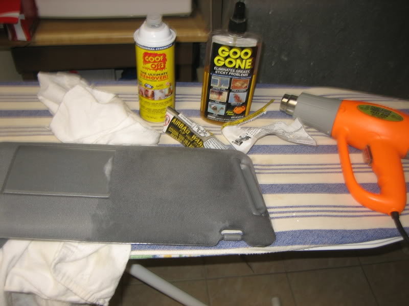

    Tools:
    If done correctly it peels right off. Only heat the side you are peeling. Stop every 1/4 and re-apply the heat.
    Caution...do not overheat!!! You will melt the sticker onto the fabric and have a hell of a time picking it off. I did this on a 2"x1" section and it took some time with my fingernail and more heat.

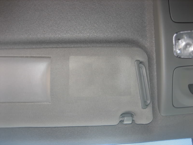

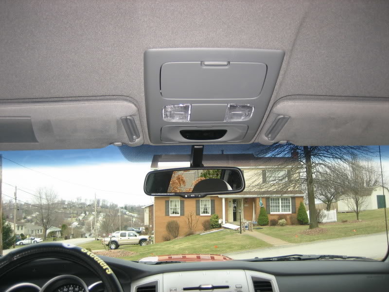

    I am not entirely satisfied with the result because there is still a noticeable shadow left on the fabric. I believe its from the glue. I also tried Goof Off to get some of the adhesive off.
    Regardless, I am much more satisfied to not look at the stickers.

    I used a nylon scrub brush under water to get the goo gone out of the fabric. They were still wet in the pictures above but look better now.
    I know it will fade out and not be as noticeable.
