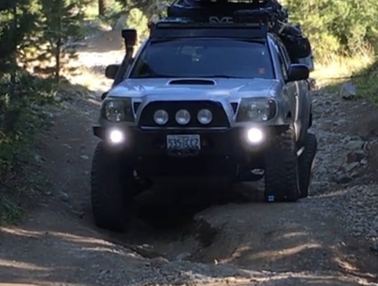

    Ditched mine 10 years ago. Makes a world of difference off-road. Here’s a good shot of one side stuffed and the other side extended with no body roll. As far as on road, I’ve never noticed, but I drive like a grandpa. Any thread about the sway bar ends up just like the ones about diff-drops. Bottom line is just go with what works for YOU.
