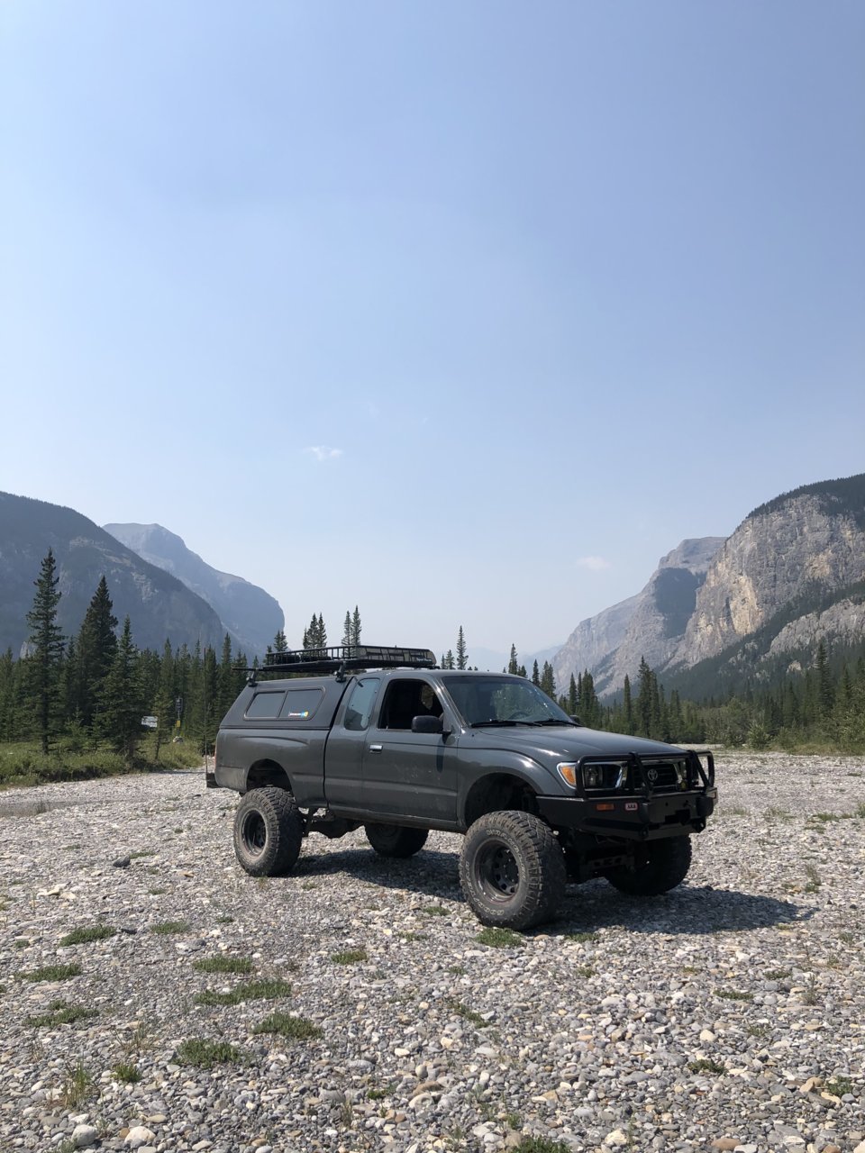

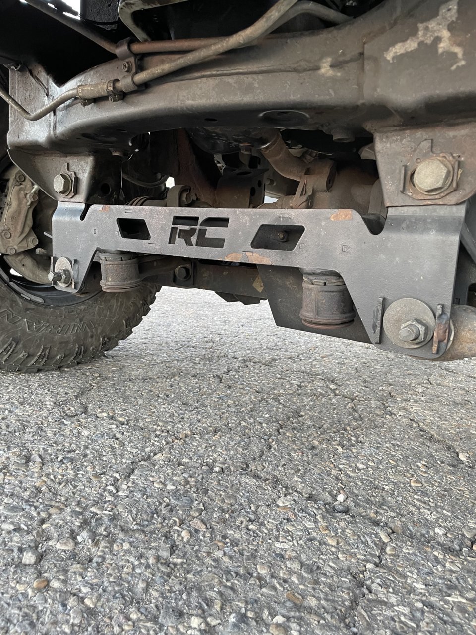

    Hey guy, I’m aware this has been covered before and I have been searching for 2 weeks or so for a detailed right up. I bought this truck because it’s frame in mint and it only had 255,000 KM on it. Unaware of how terrible these DB lifts were.
    My hopes are someone will see this thread who has endured the pain of removing these types of lifts and would be kind enough to give me a detailed right up and even a cost estimate if they had a shop do the fabrication. I am not a welder all my neighbors have welders but I want to make sure this is done properly so nothing isn’t straight.
    I have a donor truck with a cracked frame that somehow has a perfectly rust free front end so I was going to chop out those crossmembers and transfer them to this one. Any help is appreciated and thank you in advance

    Download the installation instructions for the kit that's there.
    Then you can consider what it would take to reverse that process.
    At first glance it may appear easy, but it's not.
    It is doable, but rather than just 'neighbors with welders' you'll need help from someone with well honed fabrication skills.
    Griffin6[OP] likes this.

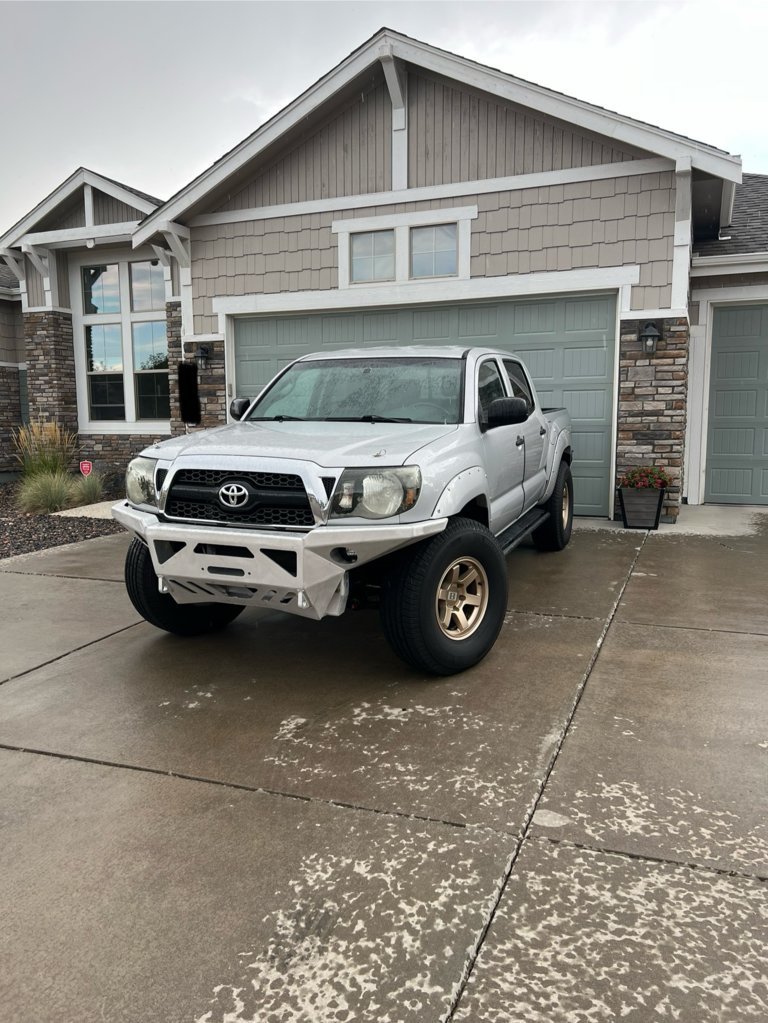

    Hey man, I’m years late to this but I’m in an extremely similar situation to you. I bought a lifted Tacoma pretty much on the basis that it had super low miles and a clean frame. Got a great deal on it, or so I thought. The lift has given me nothing but issues and I’ve had it for all of two months (not even) and I’m several thousand dollars into fixing it. But to answer your question, it’s very possible, but PRICEY. I’ve spent pretty much my entire time owning it doing research on this subject and finding out what it would take. In short, here’s everything you need to consider.
    - does your truck have a regear? If so, you still need bigger tires to comply with it. You could find stock gears, but between labor and general price of those, it’s not worth it at least in my eyes. I ended up downsizing to 33s instead of 35s per the shops recommendation, which I’ll get to here in a second.
    - How much are you willing to dump into buying OEM parts to do such a thing? I got very lucky and found at least 60-70% of what I needed off of Facebook for ~$220. But if you’re not so lucky you’ll EASILY be dropping another 2-3k on parts.
    - After weeks of setting up appointments with various custom lift shops and 4x4 shops, I finally found somebody who specializes in fabrication work and 4x4 trucks that was willing to do it. All the other shops either told me to kick shit or to replace my entire frame. Without any parts included the work to rip off the lift, weld the crossmember and throw on the OEM parts is going to run me ~$1850. In total I think I’ve spent around $1300 on parts and $1500 on tires. But the number for parts isn’t exact as I’m also having them put in new CVs and ECGS needle bearing replacement while there under there, which ran me an extra $800 ish on the parts side. All in all it’s stupid expensive to get done. But in my circumstance it made sense to do it.
    TLDR: it’s doable, but it takes a lot of time, money, effort, and looking to find everything. I’m free to answer any questions you may have, that being you even still active or curious. I’m getting all of this done next Thursday (27th).
    Goodluck!

    I will be starting this journey next weekend. I sourced all the oem stock take offs required from someone who just installed a drop bracket kit. My coworker who has been welding professionally for 10 years is going to fab the crossmember. Any issues you came across for tips or tricks?
  15. Sep 12, 2025 at 9:34 AM
    11_Taco
    11_Taco Member
    Jul 18, 2025
    #474410
    11
    Aiden
    2011 Tacoma Double Cab
    6” Lift, 35s, Regear, cbi bumper
