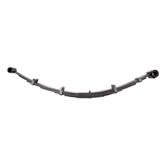

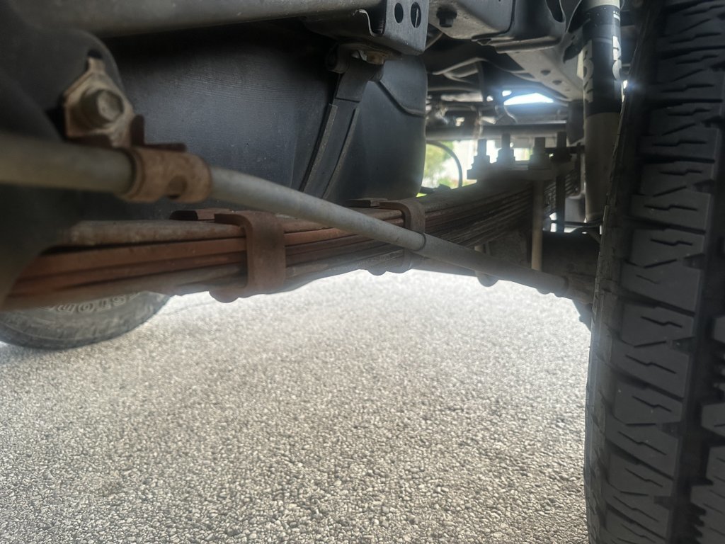

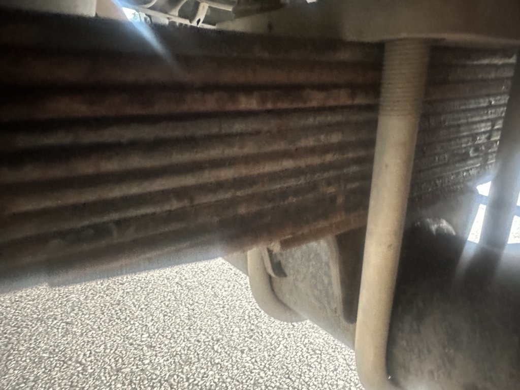

    Howdy yall,
    I have a all poo spring pack that frankly, adds way too much lift in the rear. It seems like a decently simple task to remove one or two of their leafs from the leaf pack, but im a little confused on what to do with the bands that im pretty sure prevent horizontal movement that are not held in with bolts but just by tension. Also, which leaves should be the first to go, since they have some seemingly larger leafs that do stand out. I can definitely supply more photos if needed,
    thanks!

    That's a tricky one and not sure if that's something I would attempt. If we use Dakars as an example, you can remove/add the third leaf from the top to fine tune your pack, but their leaf clamps have a bolt on top to allow this change. On yours, your option would be to cut them off which I would worry would cause the leafs to shift/fan out while cycling.

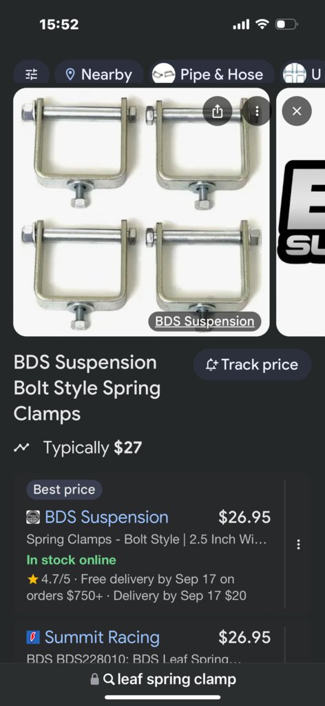

    Ive watched a couple videos and folks just seem to bend them to get the leaf out and then bend them back to clamp them down, some jeep folks. Wondering if i could buy some extra ones that bolt together, since the two in the back bolt together.
