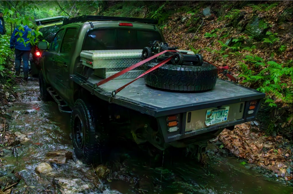

    What are you building this truck for? Id solve this issue with the springrate/valving for the weight you have rather than adding weight to make a springrate ok. Weight aint good for performance in any way.
    Going through argon... Tell me about it, just finished my flatbed in June.
