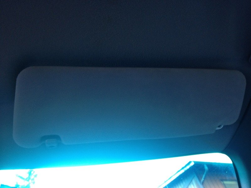

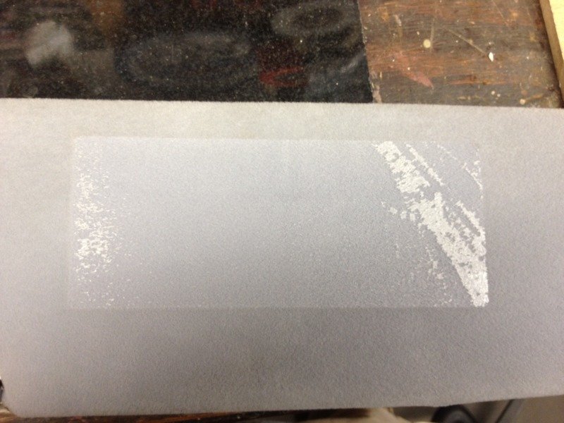

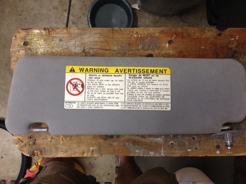

    I know I'm new but I'm going to resurrect this thread from the dead since I found it helpful (or not helpful) after doing a google search on this topic the other day...
    I took my head liner out so I decided since I already had the sun blockers off I would try to get those (in this case) nasty (in all cases) annoying air bag warning stickers off. After doing a google search and search on this forum I found this thread but it all had negative feedback (basically people saying don't do it) well I had a side already up with adhesive there, so I cut the edge of the label off with a razor and tried taking off the adhesive....
    It worked good on my drivers side (tried it on that first) and even better on the passenger side! I used goof off and that worked LIKE A CHARM. I was a little sketched out at first but after seeing how well it worked on .5" square inch part of the sticky under label adhesive I wanted to get rid of it all!!

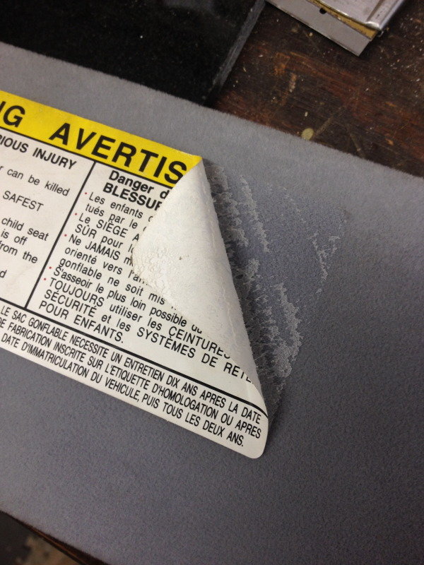

    This is the start of the passenger side (much less adhesive than the drivers side)
    Peeling (worked better if you pulled faster rather than slowly peel - don't know why, it just did)
    Fully peeled off

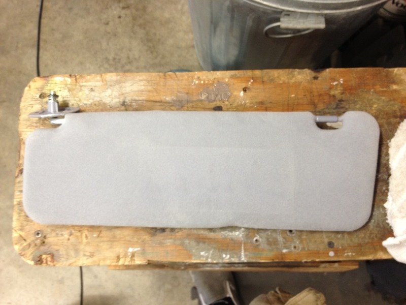

    Final product
    Bad picture but it looks brandy new
    Used the Goof Off for the adhesive and the carpet cleaner to get some of the dirt out (1999 truck) and make the label patch color difference less noticeable.
