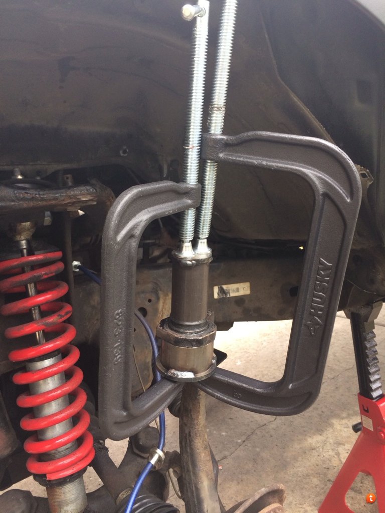

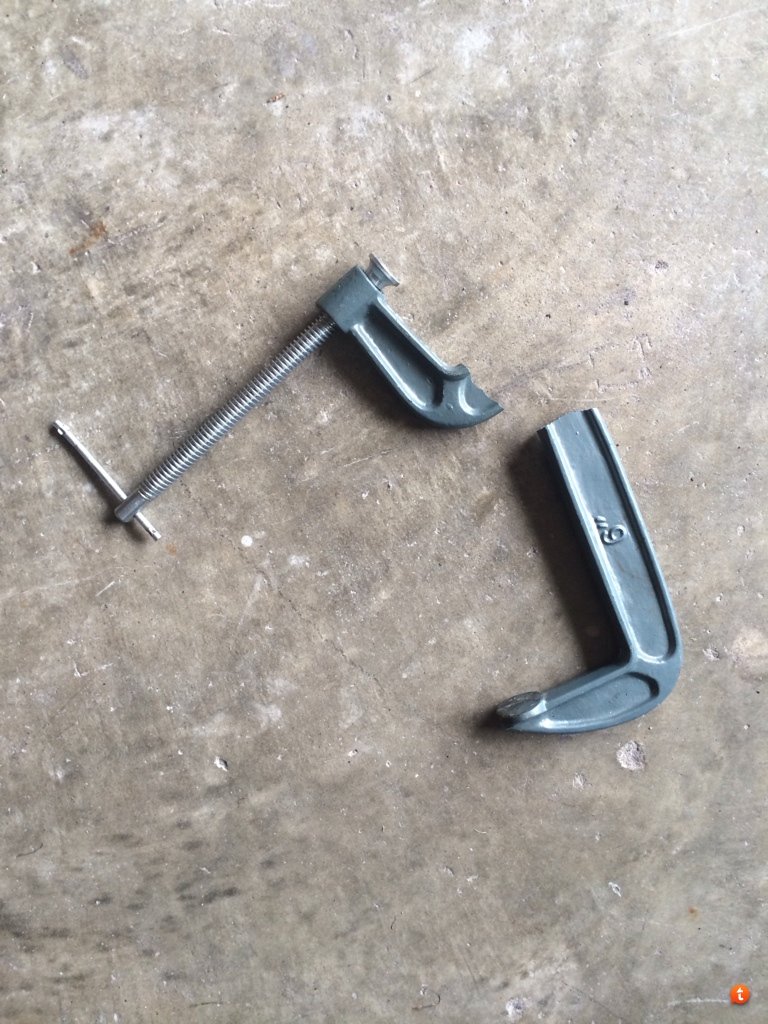

    Helping presto remove his ball joint for UCA install... We broke a c clamp already and now have 2 c clamps to get more force. Any ideas? Still not comin out...

    wd40 that thing, then while it's soaking, go rent a bj remover from parts store

    Id say rent the BJ press from autozone. Going to take some force but use a "cheater bar". Find a hollowed out steel bar that would be long enough to give you some extra leverage. My brother and I always use the handle extension attachment to our floor jack.

    Thanks guys, we ended up tightening a little more, then beating it with a hammer. Agro style.

    Use the puller like others said, a C-Clamp isn't designed to exert that type of force, they're for clamping things to hold them while you work.

    Yup, c clamps were not that great.

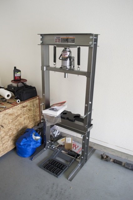

    A shop press makes it easy-peasy as well.

    A shop press or an arbor press will work too.
