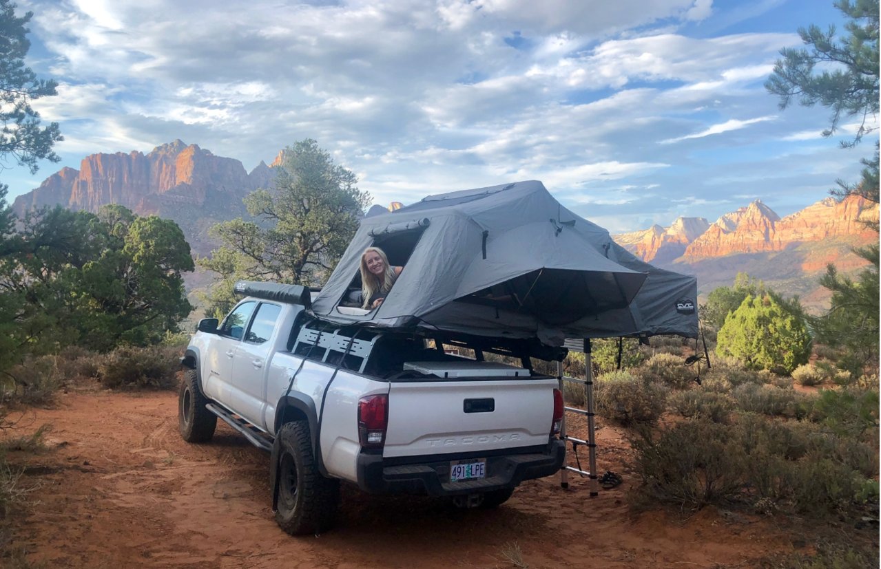

    Where was that picture taken? Awesome spot
    Malvolio likes this.

    Not sure how to verify if they are the pucks I can remove. I checked out a couple 1” lift kits to see if it was that simple but all the kits had extra brackets which made me think there was more to it.
    that camp spot is a hidden gem that is atop a hill just outside and looking down the mouth of Zion canyon

    It’s a body lift. If you zoom in on the picture you can see the additional space between the top of the bumper and the bottom of the tail lights

    Am I the only one that never saw anything except a smoking hot blonde sticking her head out of the tent?
