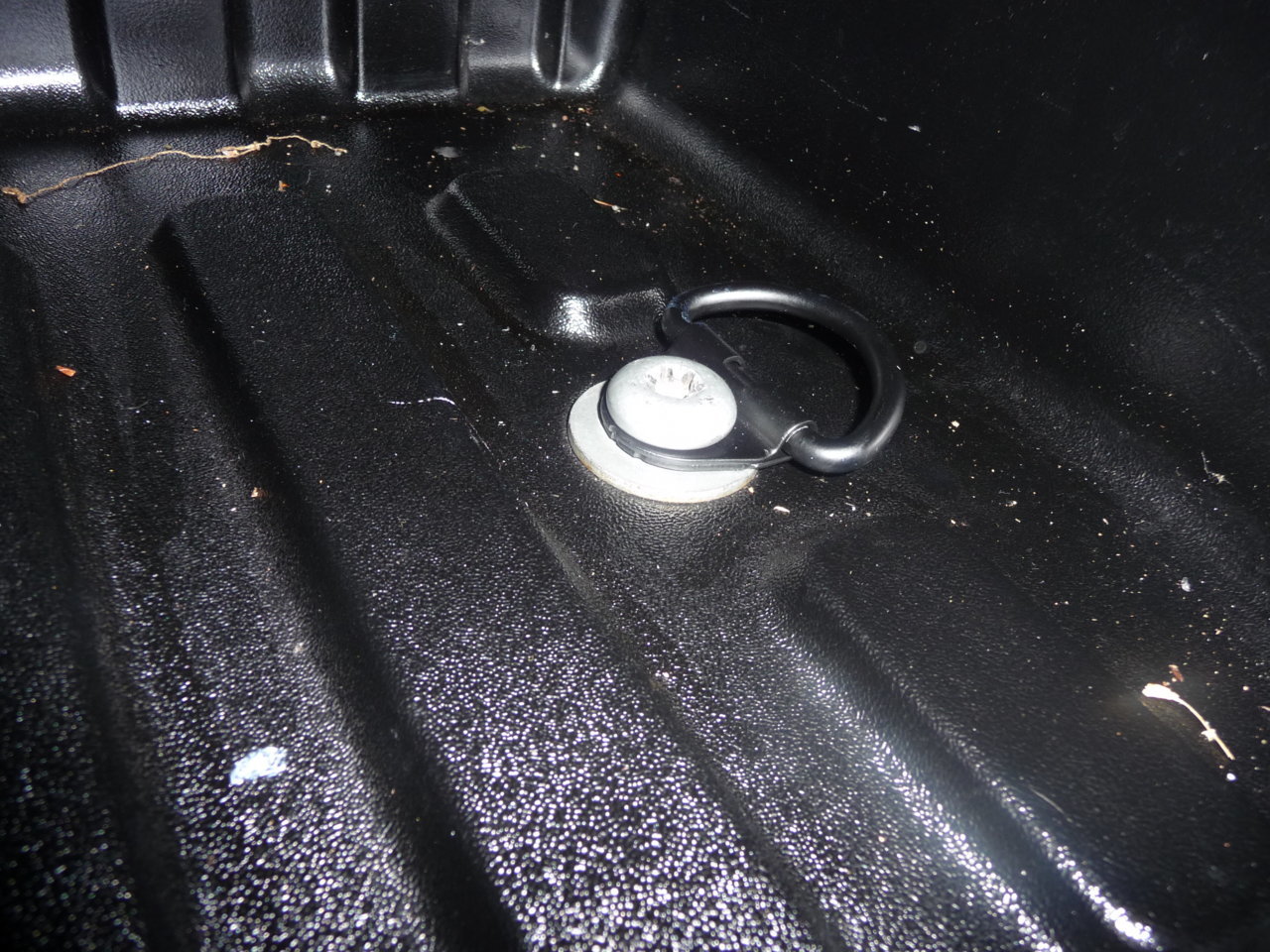

    Stop by your local big box hardware store and pick up a Torx T55 socket and stick it on your half inch drive wrench and unscrew it:
    Pulled mine and added a D-ring for another tie down point.

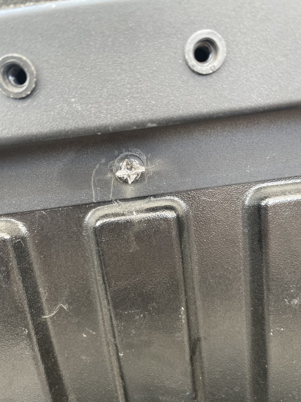

    Turns out I have the proper bit and yea they still aren’t moving and they’re beginning to strip. I figured that they had to have something on them to make them that hard to get out.
    Any suggestions on my next step?

    Best advice is to find the thread pattern and replace them with regular screws.

    Battery impact wrench worked good for me.

    Not to hijack the thread, but did you shave the bolt or drill out that D ring? I installed the cali raised ones bc you don’t have to shave the bolt, but I’d prefer something lower profile.

    I pulled mine to install the Cali front molle panel. I used a 3/8" impact gun and spun them right out. They were replaced with Allen heads that were stainless and a bit longer to account for spacers in the panels. Plan on replacing them if they're already giving you grief.
    While you still have a good, solid button head on them, hit them with PB Blaster penetrating spray. I'd dremel a slot across the head and after hitting them lightly with a touch of propane heat, spin them loose with a chisel and hammer to get them broke loose. Just shitcan them afterwards. Anti-seize the new ones.

    I am not sure. I did this originally on my 2010 Gen2 so more than 10 years ago. I just moved them forward to my 2018 Gen 3. I know I didn't shave the bolt, but I might have drilled out the D ring. Sorry, memory is the second thing to go.

    Curious what area you live in? In the rust belt after a few years its pretty easy to strip anything! And he may have already chewed the head up with the allen key.
    OP I've had better luck using an impact in situations like this. You can really lean your body weight into it. You can also pick up something like this pretty cheap to break it free.

    Extractors can be great tools but I don't recommend a cheap set. If you're going to buy a set buy a nice set. If you break one of them off in the bolt you're never going to be able to drill through it. I prefer this style over the twist ones. https://www.amazon.com/Williams-EXS-30-6-Piece-Screw-Extractor/dp/B001DNRJ7A
    Also OP this would be a great spot for a quality left hand drill bit.
