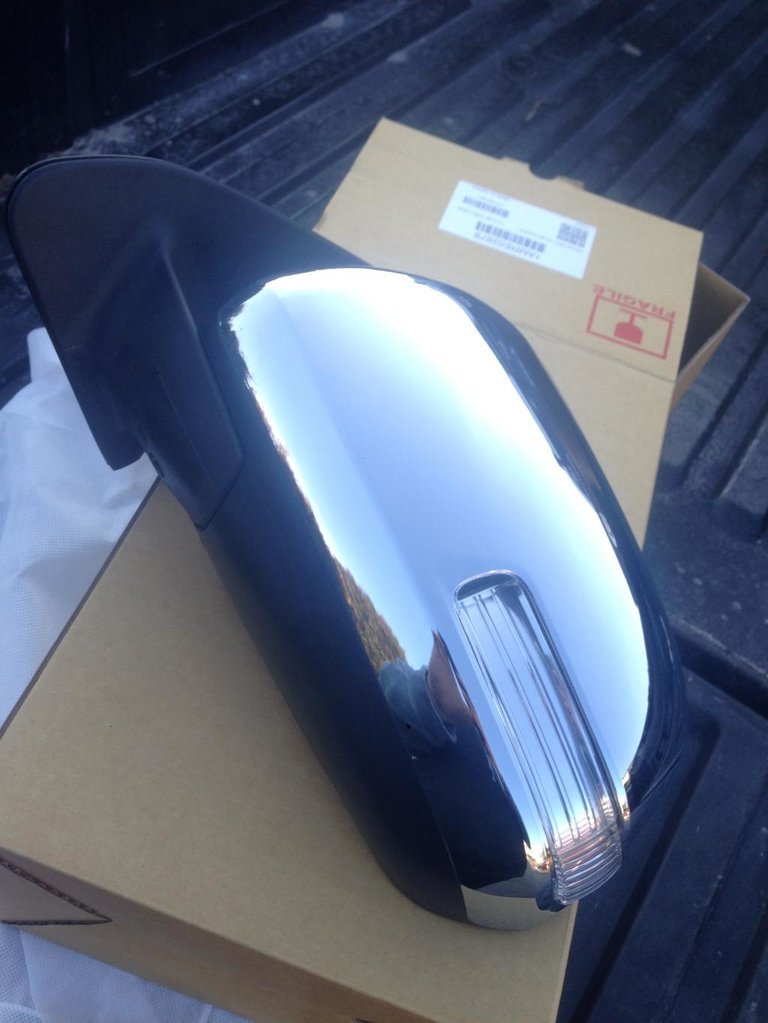

    Just bough these 2012+ mirrors w/ turn signals and they came with the chrome caps already installed.
    Going to colormatch the chrome parts Superwhite.
    Anyone know how to remove the caps? I tried prying it up but don't want to break them.

    tilt the mirror full down, or remove the mirror from the housing, there are friction lock tabs on the inside that need to be unlocked.
    boy that chrome is pimp!
    also, judging from the mold casting lines on that housing those do not look like OE ones from toyota, but the Chinese ones. use care when 1) removing the mirror 2) moving the tabs, they are delicate. i had those on my truck for about 3 weeks before i took them off and GAVE them away, they were horrible, but that's another story.

    the ones from Toyota are $170 each and the pre-painted covers are around $60. def worth the extra $150 or so over the Chinese ones. i weighed both sets when i had them and the toyota pair weighed almost 3 pounds more. the cheap ones shook so bad on the highway i could hardly see the kind of vehicle that was behind me, plus the casting lines looked like crap.

    Really? I like the look of these.
    As for the weight, they're actually pretty hefty. Feel about the same as my OEM ones.

    I need to remove mine this weekend too. id just get new prepainted covers if I were you, painting over that chrome can be more trouble than its worth ive read.

    No not really. You can't properly repaint that piece even if you stripped it. knight is correct
