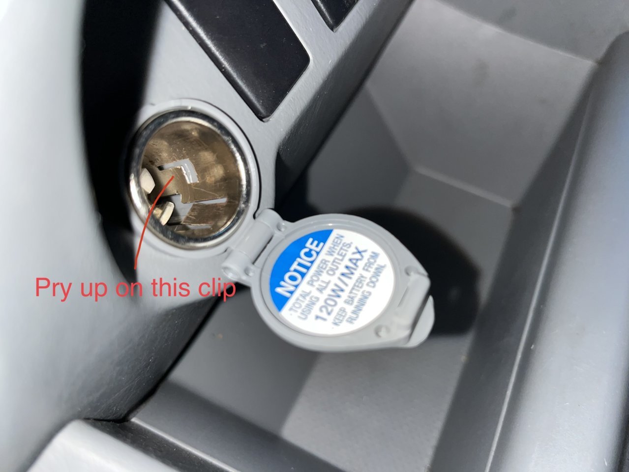

    I was able to remove the cigarette lighter in my ‘09 without removing any panels. It took some trial & error, and in the end it was similar (though not identical to) the process in the below video for a ‘14.
    https://youtu.be/LzEJX6V7KOc
    The clips that connect the metal socket to the plastic shroud were different; mine were two L shaped holes that you can see in the first picture attached.

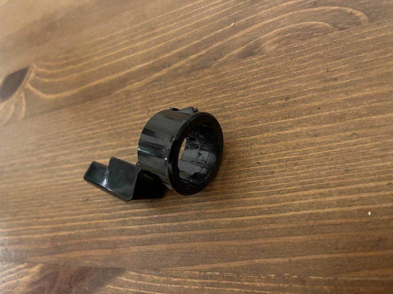

    After I released those, the socket slid most of the way out, but not completely. That was the hardest part because I couldn’t tell what was catching. In the end I just had to keep pressure on it and slowly pull it out without damaging it. Eventually the plastic shroud released, at which point I realized the clips that secure it are on the top and bottom,(not left and right as I assumed). Then I just had to unplug the wiring and everything was out.
    In ‘09 Tacomas the left socket is a cigarette lighter and the right is a power outlet with a cover. Personally, I just wanted to make them match, so I swapped out the left ring shroud with a cover shroud that matches the right side. The results look pretty clean I think.
