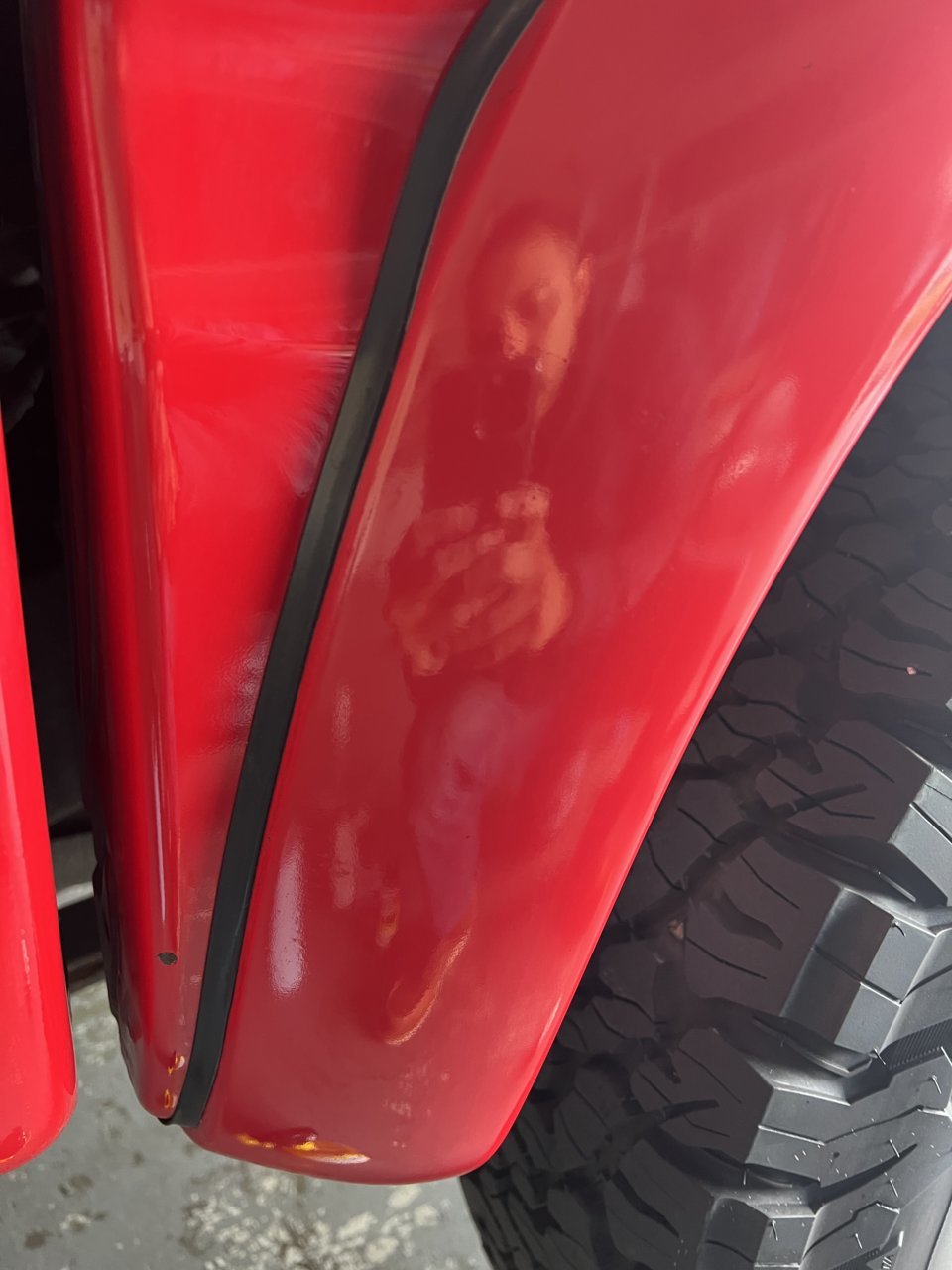

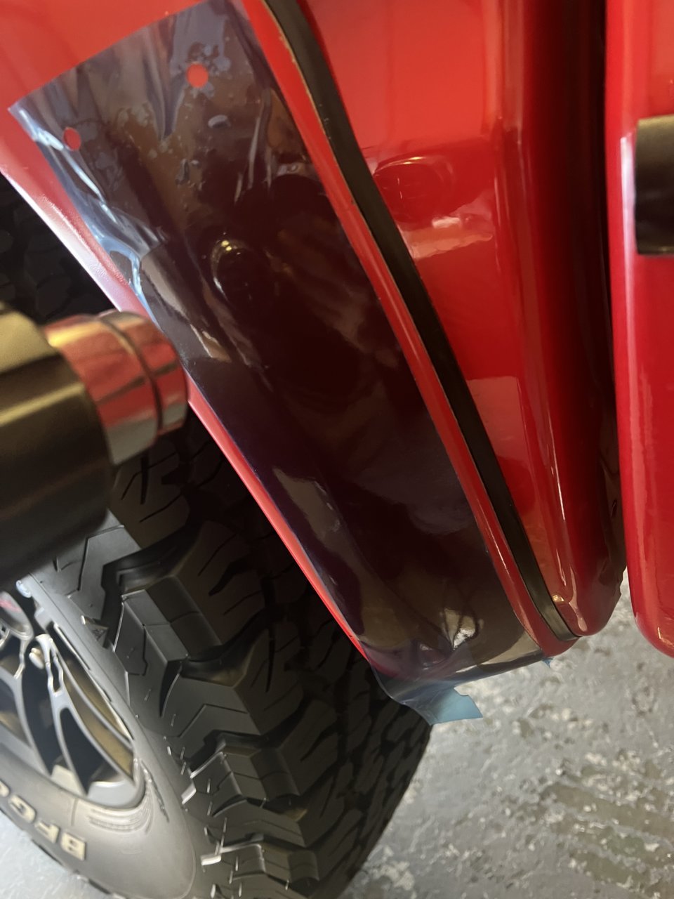

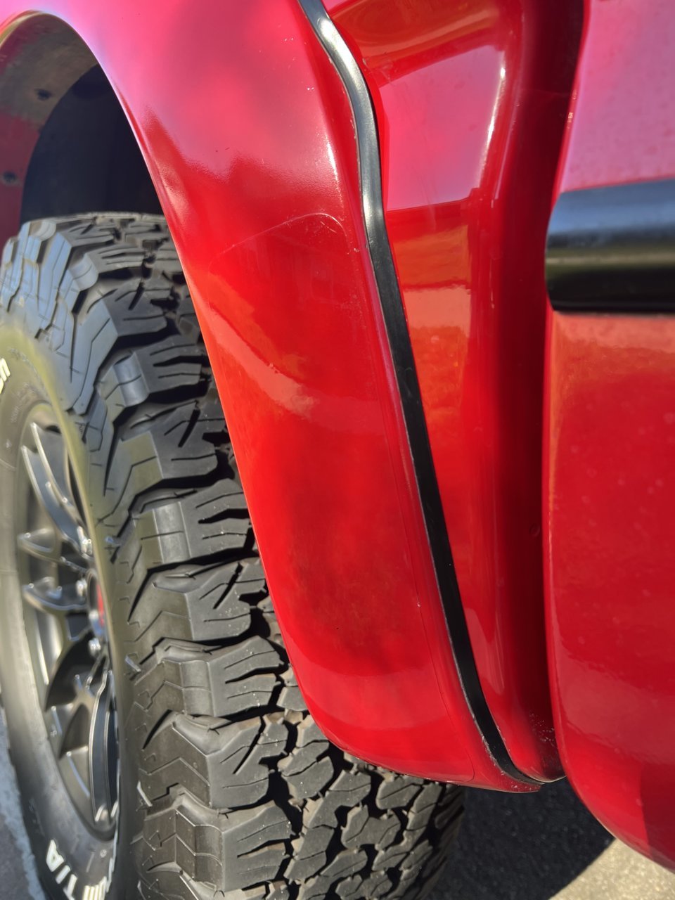

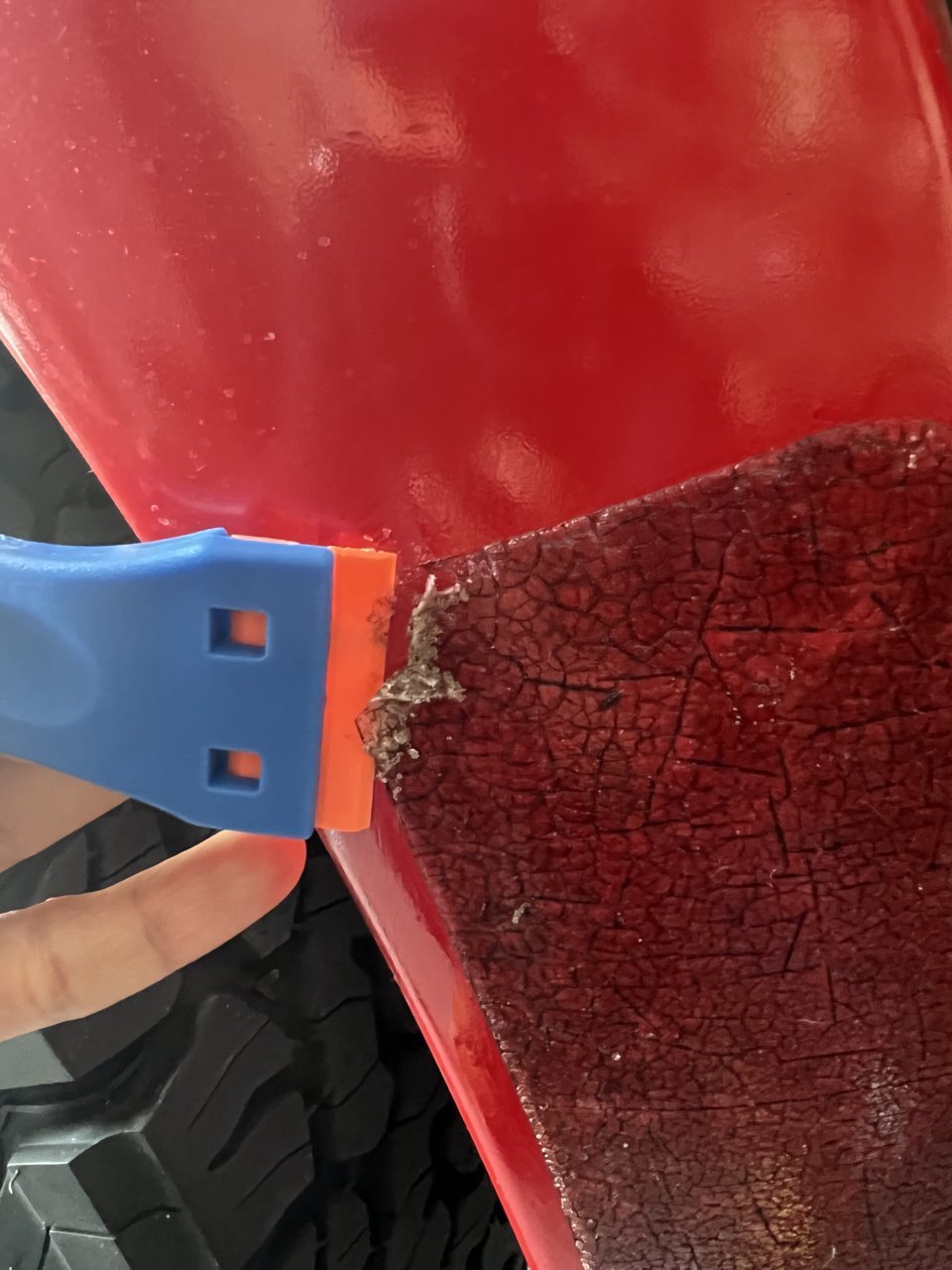

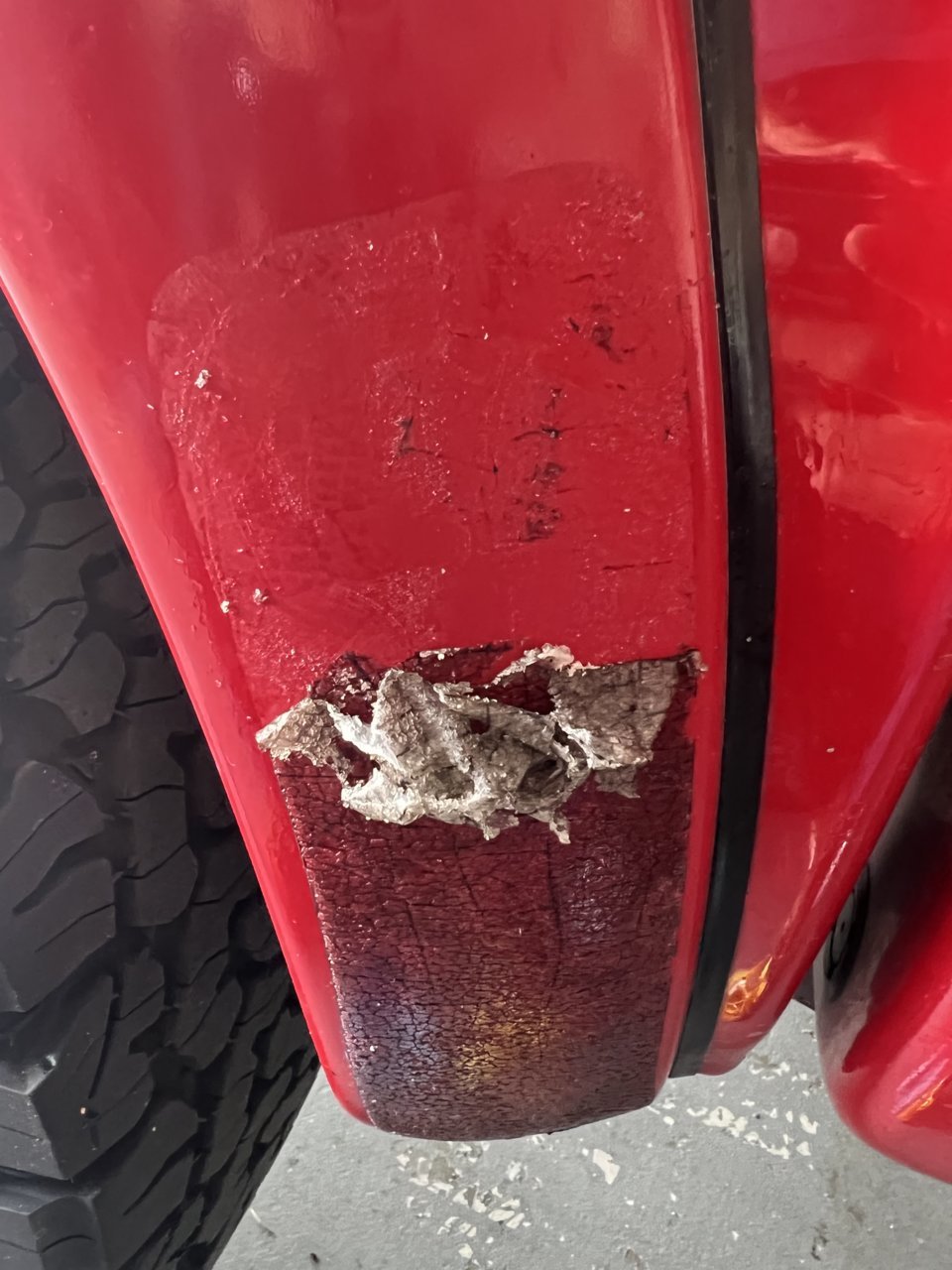

    My fender flare protectors were super crusty. Decided to look around the web but couldn't really find anything detailed. Some said to use the 3M eraser however it will remove your paint. Do not use that! I decided to use plastic razors found on Amazon and let the protectors soak in Goo Gone for a few hours. Used some elbow grease and 3M general purpose adhesive remover to remove all the remaining glue. Followed up with Chemical Guys Compound (C4) and Polish (P4). New protectors were easy to install using some soapy/water solutions and using a heat gun. Happy how it turned out. Hope this helps someone else.:thumbsup::oldglory:

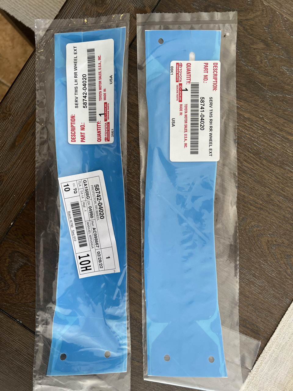

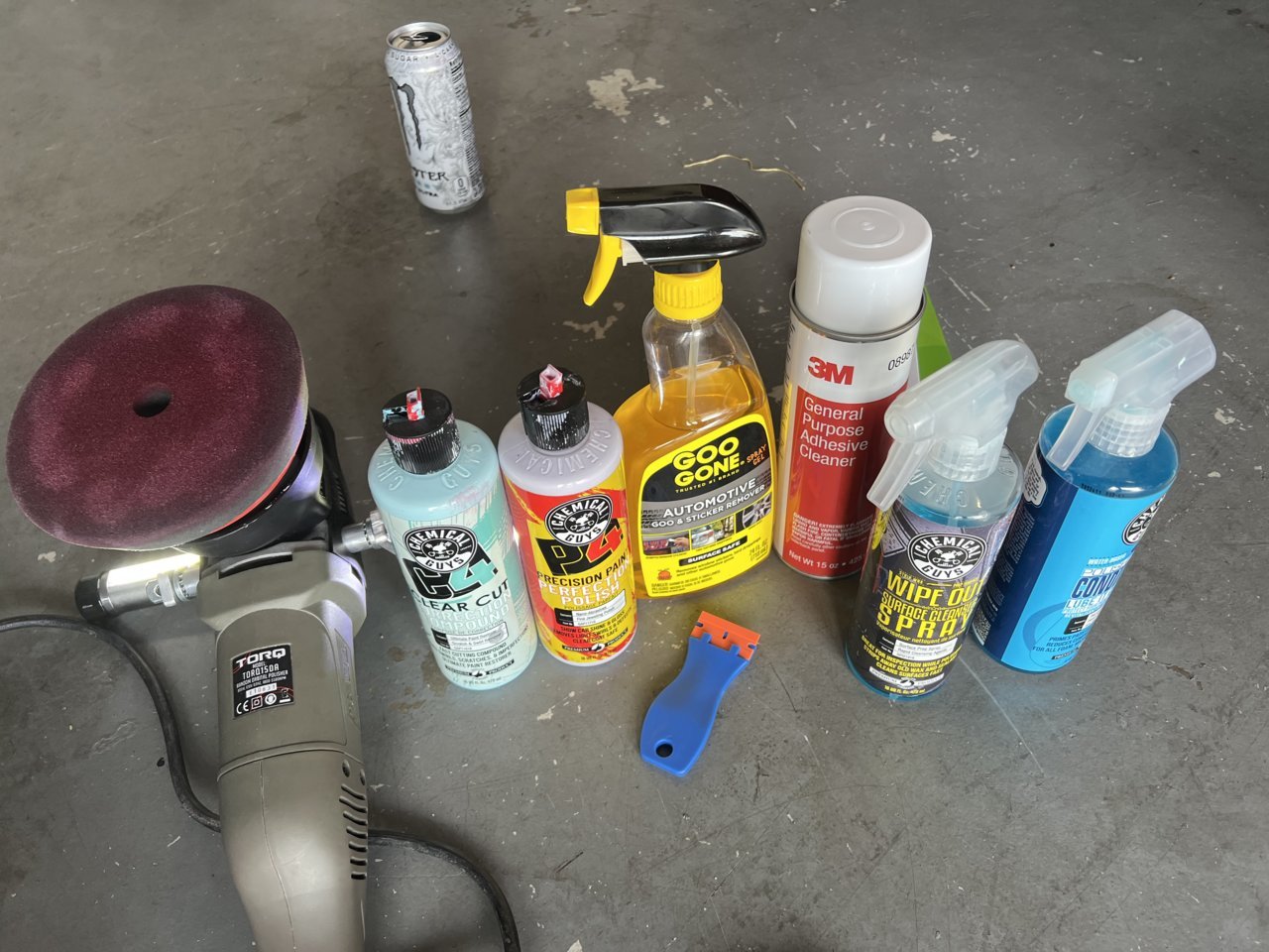

    Here are the products use and part numbers incase someone else needs them.

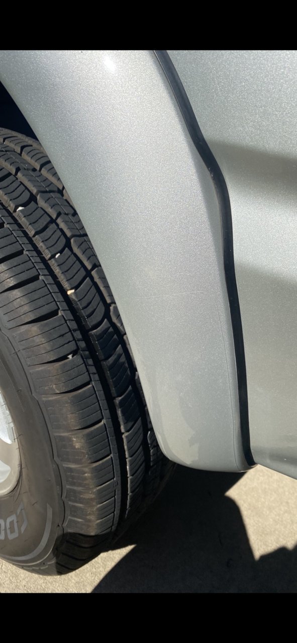

    Just wanted to shout out and say thank you for your post as you did help someone else out aka me :cheers:
    The plastic razor blades which I didn’t know existed was very helpful and with goo gone spray gel I got mine done quickly. Also I had no idea I would need a heat gun to apply the new ones , I thought it would be more like applying tint, again very helpful!
    Driver side before
    Passenger side after

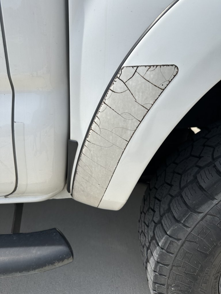

    2003: Stock 2007: Avid Offroad sliders, 30% front tint, bed mat, Truxedo low-pro qt tonneu cover, aero turbine 2525 muffler w/ 8'' tip, AR25 Resonator, 16x8 Dick Cepek DC-1 w/ 265/75 Goodyear Wrangler Duratracs, 2010 headlights, ome 884 coils with .5'' top plate spacer, OME sport front shocks, bilsten 5100s rear, 2'' aal, locking gas cap, LR ucas, Viper 2-way remote start, afe drop in filter, Rocky locking bike mounts, gear chest, scangauge, pop n lock tailgate lock 2013: most things transferred over from my 07, 5100s @ .85 + eibachs and Toytec tps for 3'' front lift, wheelers progressive aal w/ overload; compustar 2-way remote start; Antennex shorty antenna, pop n lock tailgate lock with programmable key, seat covers, Toyota's crappy all-weather floor mats (should have got Husky's or Weathertechs), TRD skid plate, led light pods mounted in front bumper valence w/ Eyourlife wireless harness and remote, led bed lights, light pods mounted in bed, Devil Horns emblem from Diaz Fabrications, rear facing pod lights in bed, under seat lights,

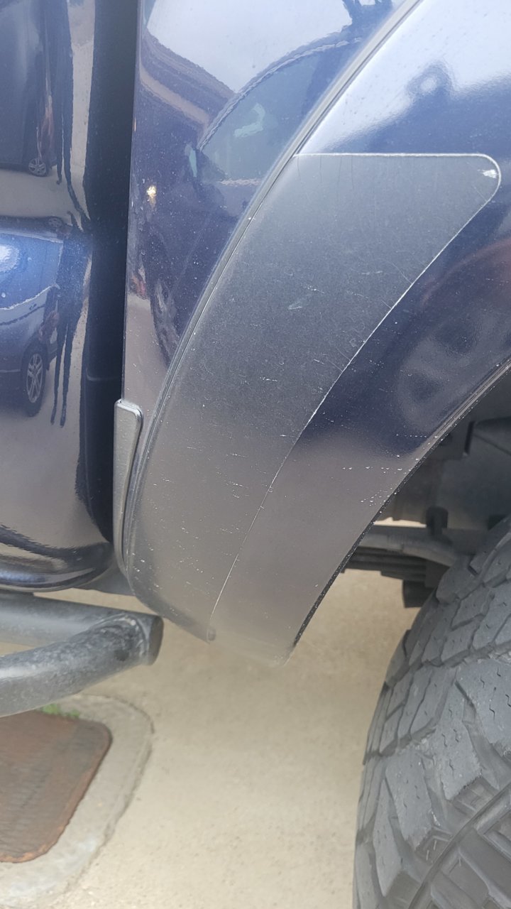

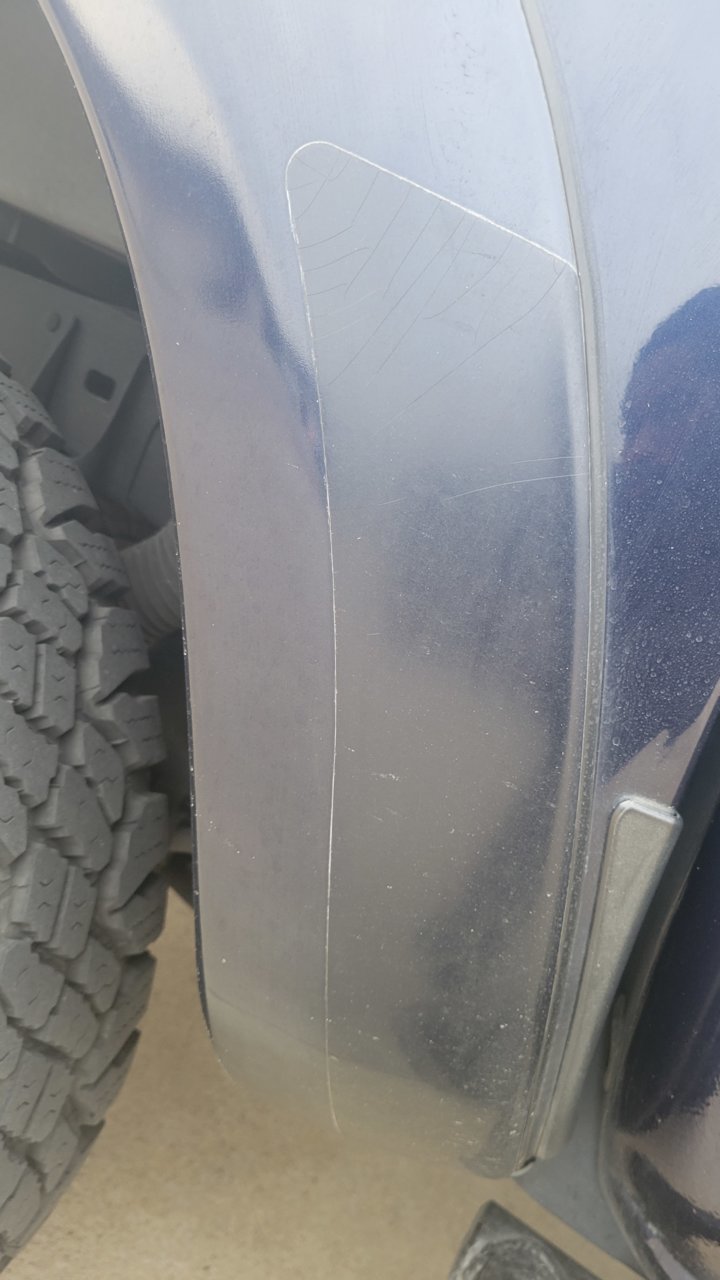

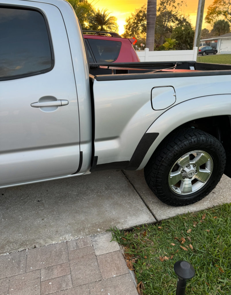

    Mine aren't super crusty yet, but they are starting to crack a bit and look hazy. Going to try to knock this out soon before they get worse. Did you use the heat gun at all to loosen the adhesive to remove the old protectors?

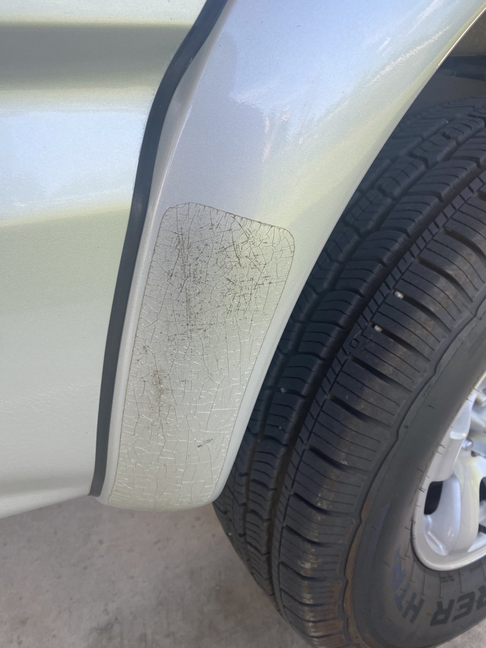

    Stock (99.999%) OEM Bed Floor Mat, Front Bed Rail Cargo Net and hooks, Auto-Dim mirror w/Compass and outside Temperature display, TRD Pro Grille, Uni-Filter air pump modification, WeatherTech floor liners f/r. OEM All-Weather floor mats (summer).
    These are all great posts on this job. Even though the ones on my truck aren't deteriorated like some of the the ones shown here, (even after 9+ years) they are showing their age with some small black dirt spots all around the edges of the fender-flair ones. (White truck) I'm glad they are in place: (thoughtful touch by Toyota) but what's ironic is there really doesn't seem doesn't to be much, if any, road-rash on them from sand, stones, etc: they feel pretty smooth and except for the edges still look nice.
    I'll be working on them in the spring when the warmer weather returns. I actually probably could have done them this week: It hit 60+ degrees in some places here in central and eastern New England. I installed my Pro grille on Friday in 50 degree temps: Who'd a thunk I could/would ever be able to do this outside in mid-February?
