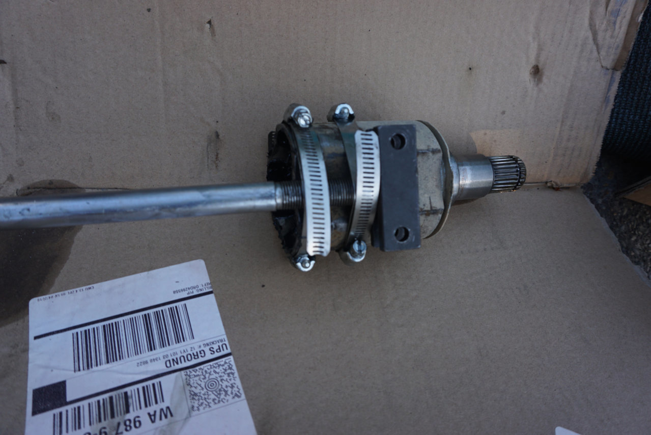

    I have trouble popping the inner tulip out of the differential. FSM says tap in a screwdriver between diff and CV. So first I tried prying and tapping it out. No go. I damaged the soft differential casing on driver's side. But, I've seen prying work easy on videos. Then I tried a slide puller with special CV joint removal tool. That worked OK on driver's but damaged the dust seal. The tool didn't fit into gap on pass side. Resorted to impact hammer which then mildly damaged the tulip.
    This time, I used the slide hammer again but strapped it snug to the tulip with hose clamps. Had to pound pretty firmly but it worked. Only challenge is getting underneath the axle to tighten the clamps. But, no damage.
    What other tricks are there? I have searched and understand that for some people this is a trail-side fix. One video wrapped some 1/8" wire rope between the joint and a wood chopping axe. I don't think we can get wire rope behind the joint. Others try vice grips, which I forgot to mention, slid off for me.
    This pic shows pass side out with residual dust seal damage from earlier removal attempts.

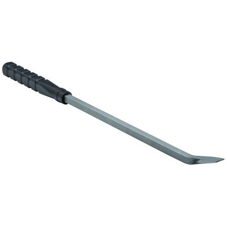

    Use one of these:
    And a hammer. Deadblow works well.
    Smack lightly. If it doesn't pop out turn the tulip 15° smack again lightly and itll eventually pop out.
