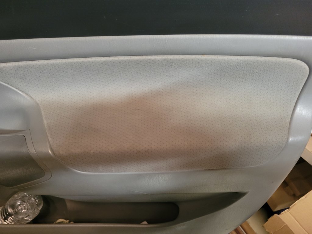

    Remove this fabric cover to gain access to lock assembly or to gain a handle to remove door panel when door won't open
    deanosaurus likes this.

  5. Feb 21, 2025 at 12:55 PM
    deanosaurus
    deanosaurus Caveman
    Jul 23, 2018
    #260241
    2,154
    Northeast Region
    09 TRD OR AC
    Those are heat welded I believe, did you have to pry it out hard? You can reattach it from the back with small screws or you can try to re-melt the factory pegs.
