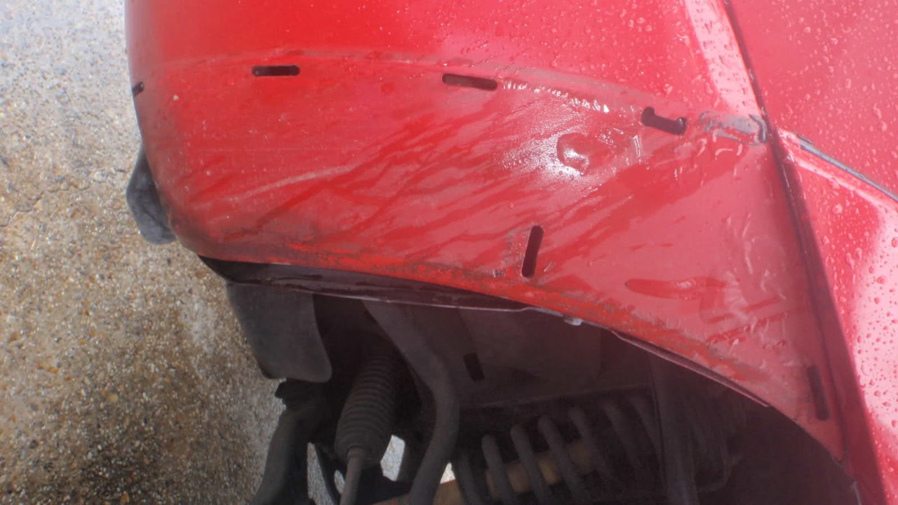

    My fenders look like this::
    I want to take them off and have them painted.
    ?#1 Is the body painted under the flares? and should be okay without them?
    ?#2 I see people say the clips break a lot, well I noticed my Fender Flares are missing a few clips here and there. I can tell they have been painted before.
    It's strange because every thing on this truck looks brand new, but my fenders are chipped to hell.
    Well 1 and a quarter are. It's just the driver front-piece that's on the bumper, and the passenger rear.
    If in this situation, what would you do? I can't go get them painted right now, I have two cars I have to sell that I'm still paying insurance on. Then other BS. I bought this truck on a whim, glad I did, but I can't justify putting much into it. Besides necessary maintenance, and free-(or cheap) mods.
    But I can't drive in something that looks that bad, I'm making Tacoma's look bad driving with those fenders.

    I've never had the fronts off but the rears came off easy enough. (A few screws in the fenderwell and then pop out the plastic clips)
    The plastic clips WILL break when you take them out so I would grab a few from the dealer ($$) or order online first.
    http://www.clipsandfasteners.com/Toyota_Fender_Moulding_Clips_90904_67036_p/A20390.htm
    If you don't want to spend the money right now to have them painted professionally, I would take them off and rattle can them satin black. It would look repectable until you are ready to have them done professionally.
    Other options would be bedline them or Plasti dip.:thumbsup:

    The plastic clips are available at the dealer. When I bought my truck, I hated the "orange peel" look of the fender flares. Seemed like all the Tacomas in the area were the like that. But on the same lot, the Tundras with fender flares had beautifully matched fender flares with the body color. So, I found there was a TSB on the fender flares and I had the dealer paint mine right after I bought it. They look great, like they should. My point is, maybe the previous owner had the flares painted but the job was not done properly? Or, he could have been rear ended and then hit something up front at the same time, then had the work done on the side which would not show up on the Car Fax? Look closely and you should be able to tell. Good luck...

    Those clips above look right, but be aware there are two separate sizes used in there.

    You could paint them up with something like Line-X. That crap sticks to anything! They can color match also so it'd match the truck and have a nice texture to it.

    I'm at a loss, but in the last ten minutes I had a friends paint-guy out here. He looked at the fenders and chipped some paint off and said there was no binder between the plastic and the paint.
    His advice "Don't go through anymore car washes"
    He then agreed to paint all four fenders and my front bumper (has scrapes from front license plate, and a scrape by fog-light), if I changed the motor mounts on his wife's Malibu.
    So good trade I think.
    I'm taking the four flares off now, so he can paint them this weekend, and gonna drop the truck off Tuesday for him to paint my bumper.
