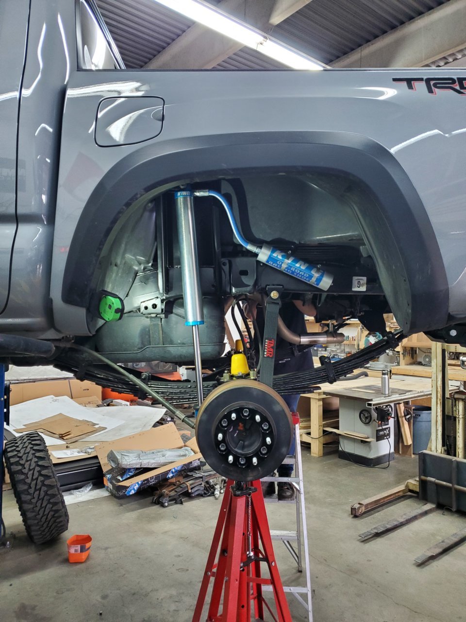

    Yeah I own a Toyota off road shop. We always remove the leafs!
    Just did this one last week.

    that is a baller ass end.
    I did one hammer hanger today while I had a few spare hours. Honestly, the rivets weren't that difficult. the ones in the side of the frame popped right out with a 3lb hammer and a bolt/punch. the bottom ones I had to drill, but it was easy as pie. I really don't know why anybody has to spend 30 minutes each drilling these out. they drilled out in 5 minutes max for me. I used a 1/4" bit for about 3/8" up into the rivet and then followed it with the 1/2". one of the easier parts of the whole process.
