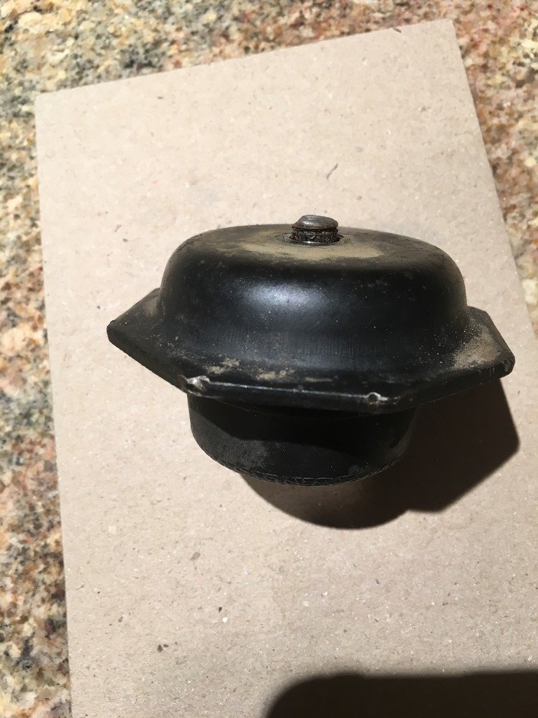

    hey quick question about front bump stops...
    Is there a nut fastening it to the "frame" or is the bump stop itself threaded into place. Meaning do I need a socket or do I just use a big ol pipe wrench?

    Big old pipe wrench is all you need to get it off

    Or large channel locks.... ive heard of ppl using a strap wrench too

    Yep just screw off, large channel locks or pipe wrench

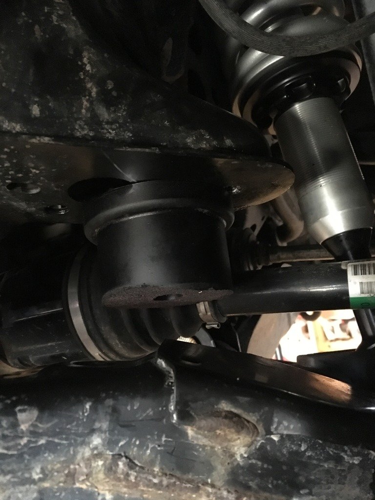

    Tried removing mine today to install the superbumps and the bolt sheard off clean in the frame.
    Is the top nut afixed to the frame? Trying to figure out how to proceed

    Some
    weld a nut to the broken stud or drill it and thread the nut. or try an easy out

    This will be fun. I'm not even sure if I can even fit a drill in there.

    for sure you will need a 90 degree drill, and it will be a pain in the ass.

    Yeah, probably. Im not sure if that broken studs going to come out with an extraction kit, the top is probably rusted into the nut.
    Might be easier to just drill it out and instead of retapping it just put a nut on the bolt that the superbumps come with.
    Hope the drivers side doesnt end up the same way. Trucks only 4 years old

    Went out and bought the smallest compact drill i could find and its still to big to fit in there with the lower control arm on. The way I see it theres no way to get a bit in there square without taking the lower control arm off.
    For now I ended up using a hole about 2" away from the factory location and putting a nut on the screw to the superbump. I had to cut down the superbump to leave some clearence it was only leaving about 1/2" at full length.
    Going to have to find somebody to tare the front end apart and get that bolt out, I dont have the facility to do it.
