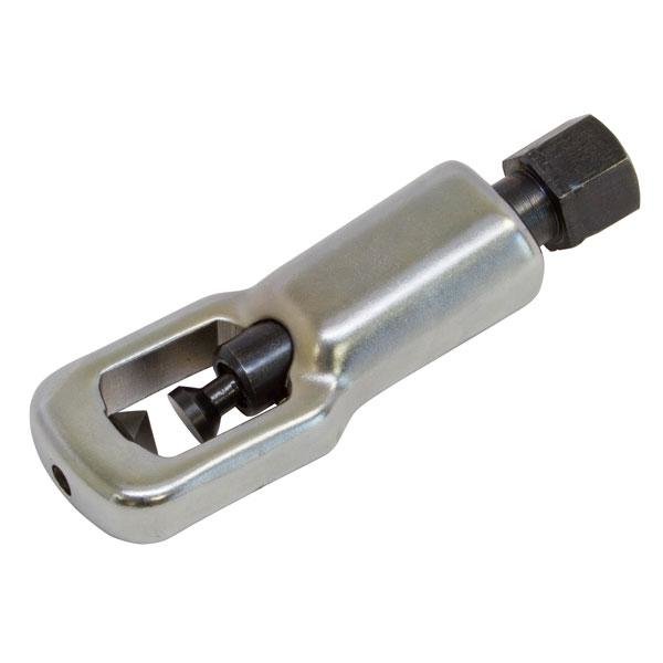

    so while trying to loosen the three nuts at the top of the strut hat, the rear most one, rounded off the corners of the nut using a 12 point socket. What’s the best way to remove it now? that bugger is in such a tight spot. Try to force a 6 point socket onto it?
    The two that are more visible and accessible, no problem, was able to break them loose.

    Nut splitter.
