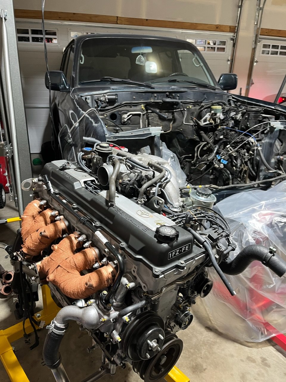

    Ya the 80 is gonna be a lot different. That’s a fat body that needs the rear sway bar.
    I would remove the front and leave the rear as is. Many of us have off-roaded the heck out of our trucks and still DD them.
    FYI this is the current state of my 80
