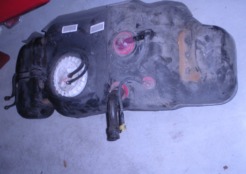

    I have a 2008 Xrunner. I did it by myself in the garage. Like mentioned before, an empty tank will make your life easier. I lowered the tank with the use of a floor jack and a 2 x 4 resting under the tank.

    It has been a few years since I did this.
    As I remember, the fittings are basically a squeeze and pull to get off.
    I dropped mine using a floor jack. I also stacked 2 x 4s on the front and rear of tank. I would use the floor jack to drop it a few inches, then I would remove a 2 x 4 on the front and rear. Then drop it a little further. I did this until I had it on the garage floor. This way if it got away from me it would only fall a couple of inches.
    If you have a helper, it will be easier.
