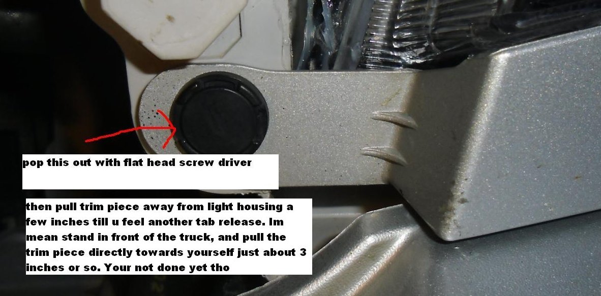

    make sure u remove the trim piece directly under the headlight.....then when u get to that "screw", I just pull the bumper skin away from the screw....its flexible and wont break........Ive done this probably 2 dozen times on diff trucks and projects

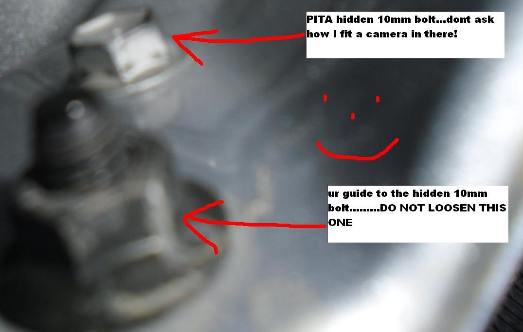

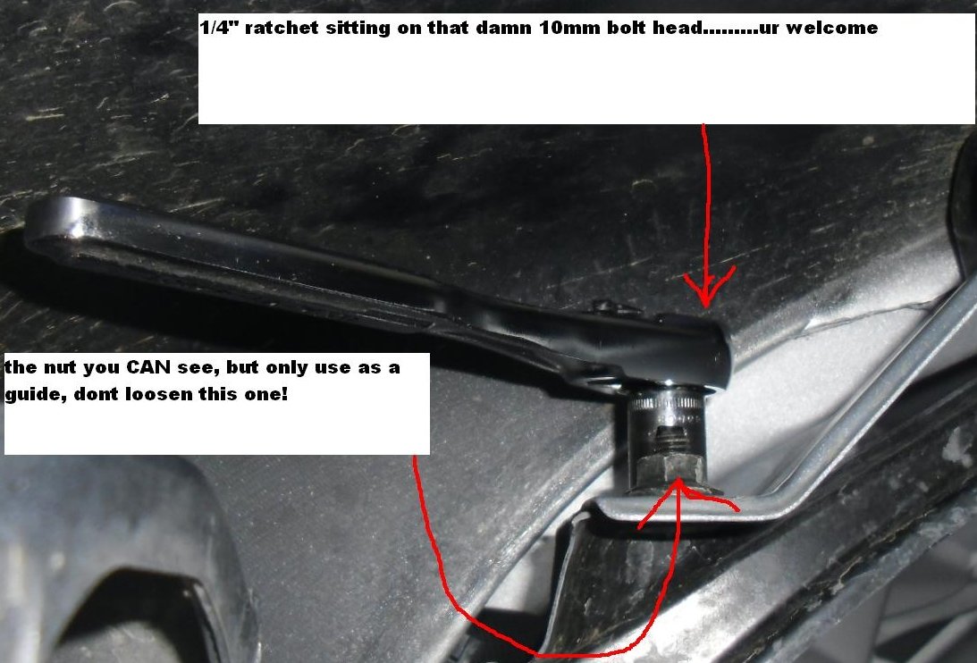

    if ur refferring to the one under the truck (bolt) then remove the 2 screws holding the front of the mufguards to the skidplate area, and fold them back onto the front tires (they wont break).......then use ur hands and feel for a nut to turn up by the headlight....then reach about 1" above that, and thats the bolt u need to undo.

    heres the bolt UNDER the truck most ppl have problems with.....hiddenboltandguidenut_f2e589d10990d5a3baa8ca726e3c25926f5c4bf2.jpg
    and another view
    trim piece
