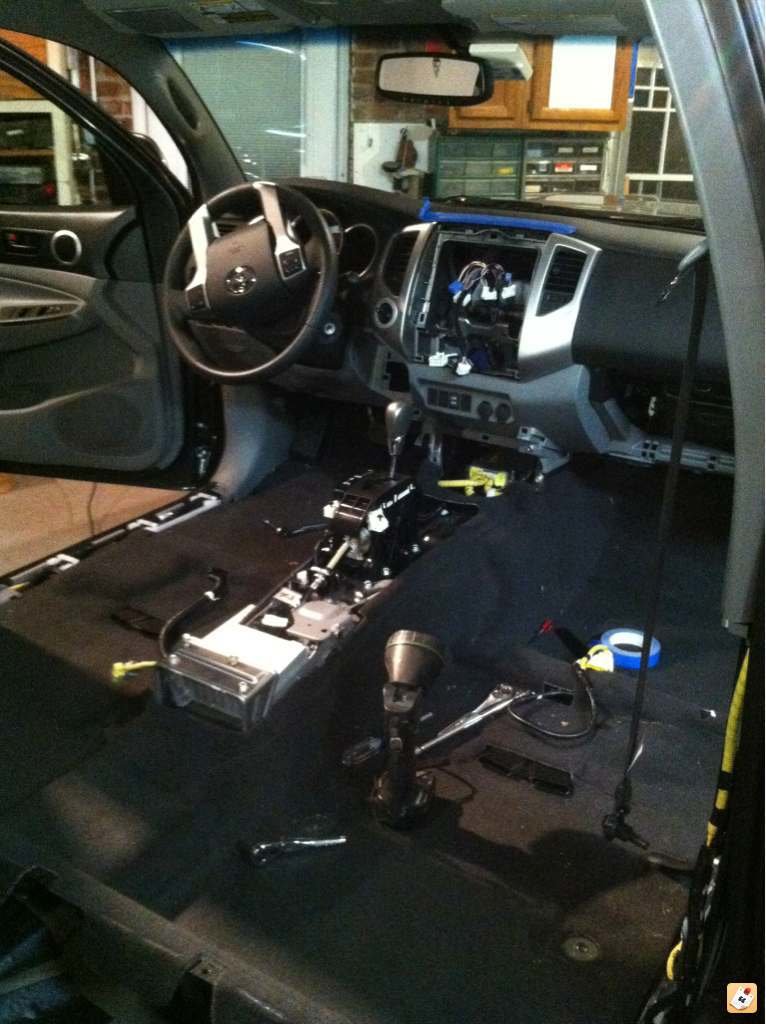

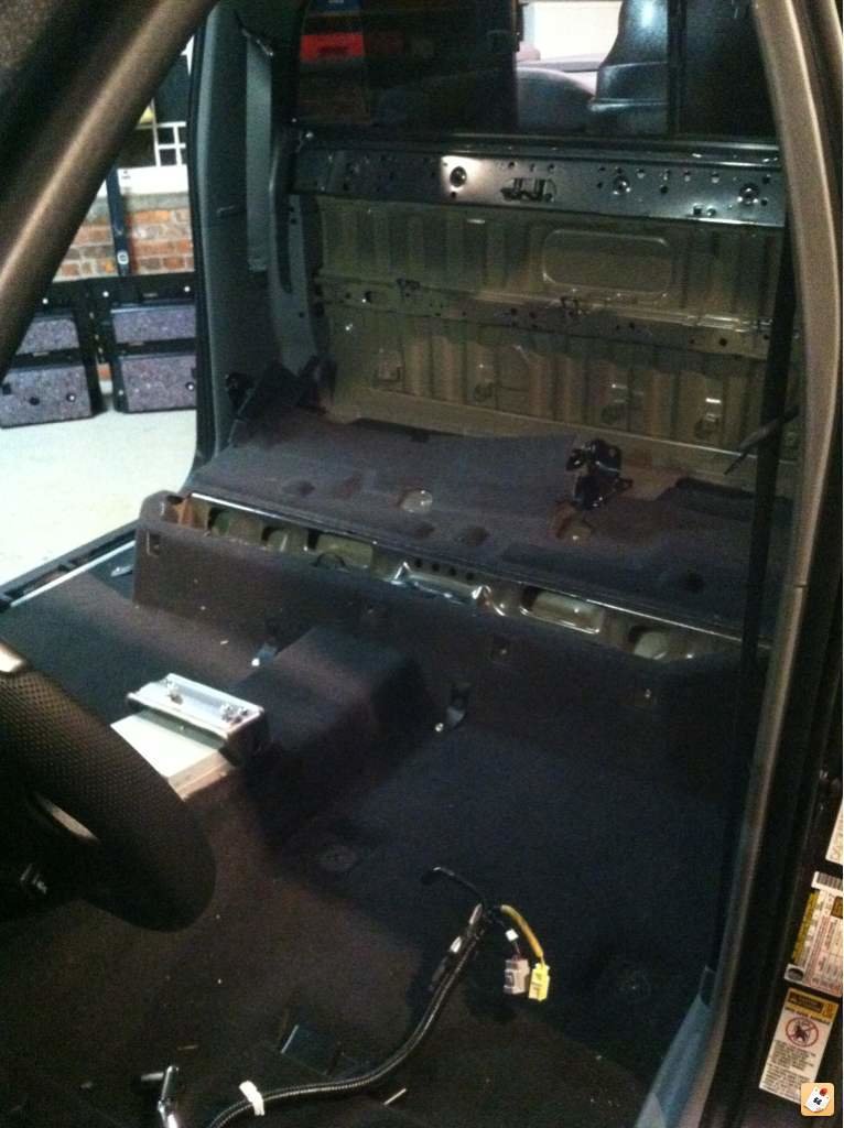

    It's not hard at all. Four bolts and a plug for each front. Two bolts for each rear. Center console will be the hardest.
    This was for my stereo install. e5yqe3aq_f4519e887c80f9209d687bd794fa4145cb10c370.jpgpuqamume_5ab5b4cae14ed9f23d2ecee19baff46c2f034cab.jpg
