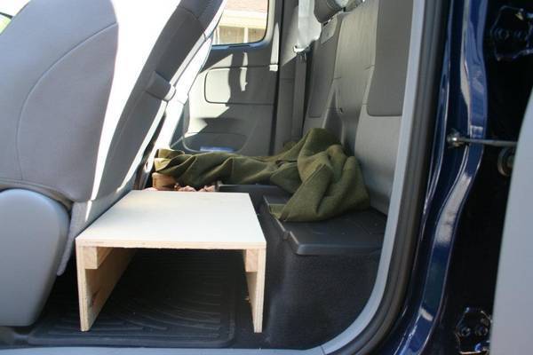

    So far as I can tell, you can't remove the storage boxes and gain space, you just get a hole in the cab. The 05 tacoma used to have seats that folded flat, and that was awesome, but the newer versions have the jumpseats.
    Here is a pic of what I did. The seats come out easy, just three bolts each. I just made some boxes to sit on the floor and level it out. I need to engineer something to cover the center console. For the moment I have it stuffed with blankets and the dogs don't seem to care too much.

    Beautiful! Thanks MB. I've been lurking and searching on TW the past hour since posting the original question and I've seen a lot of solutions to this common problem (stupid crummy 2009 rear seat design grumble grumble). It's good to know that the rear seats, headrests, and center console are removable because those suckers are outta there. My goal is for a nearly-stock looking system that has lockable lids and maybe a lockable drawer that slides out of each side. Like I said, I'm a pretty decent woodworker, though car mods are new territory for me.
