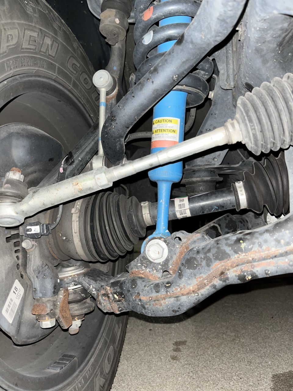

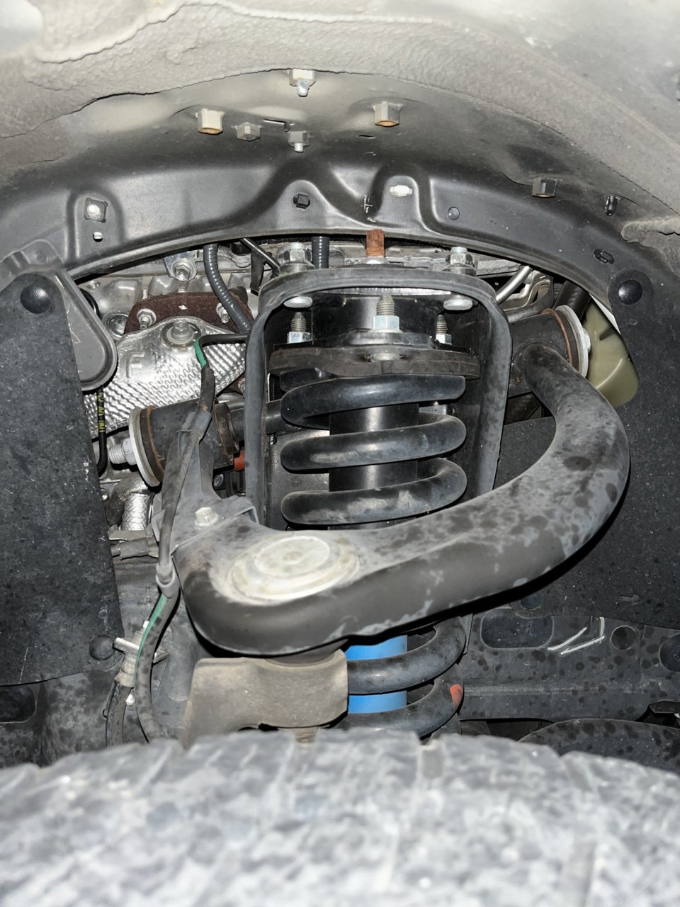

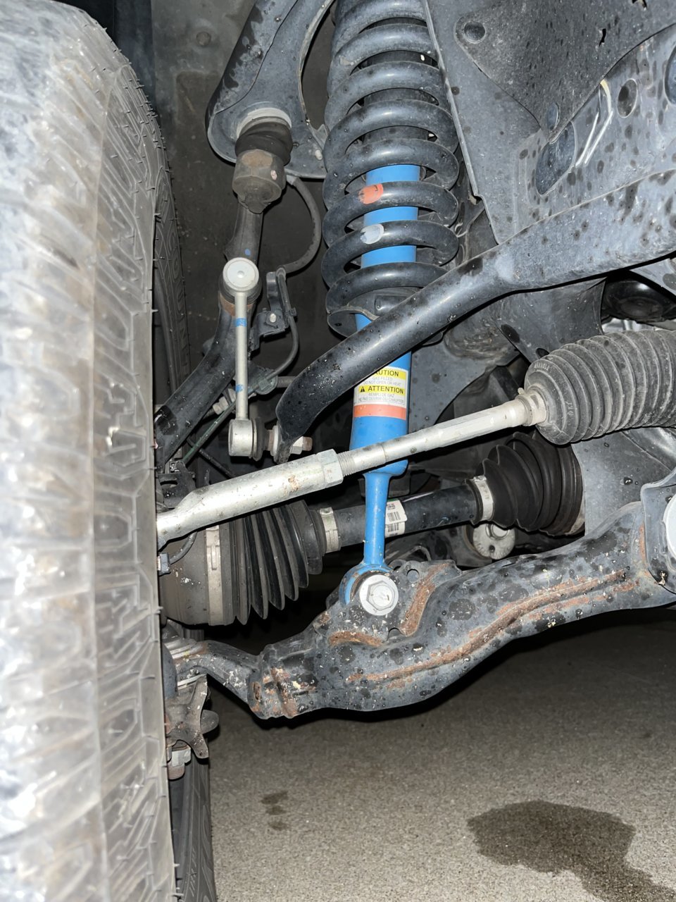

    Here are three pics. Hope these will give you a better idea of where my lift is coming from.

    Leveling kit. Stock suspension with block. That's it.

    I’m no expert, but it looks like you have spacers above the coils.
    A stock front should have just a thin isolator between the spring and bucket.

    That spacer is the leveling kit I believe.

    The front it looks like you have a 1.5-2" spacer, which provides roughly 3" of lift.
    - Rear lift the spacer size equals the lift amount.
    - Front end is different. The spacer is compressing the coil spring, therefore the lift gets multiplied. (I was incorrect with this statement, see below)

    If you take out both the blocks on the rear axle and the strut spacers on the front you will be at stock height minus any wear & tear on the leaf springs and coils. Sounds like you will end up very close to your son's ride height front and back.

    You have a 3/2 leveling kit on your truck. The front has a 3 inch strut spacer and the rear has 2" blocks. If you wish to remove the lift, you pull the struts, remove the spacer and reinstall the struts. Then you will need to jack up the rear end, remove the blocks and probably have to put a standard length set of u bolts in the rear.

    A couple of things:
    -The front spacers add no preload to the suspension.
    -The front spacer lift is multiplied because the strut mount is about 1/3 of the way between the lower control arm pivot and the ball joint pivot. Total lift in the front is approx. 1.5x the spacer height.
