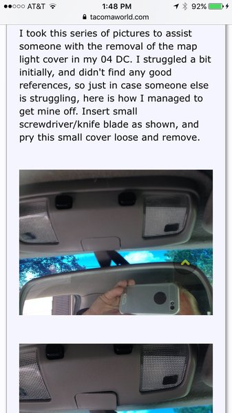

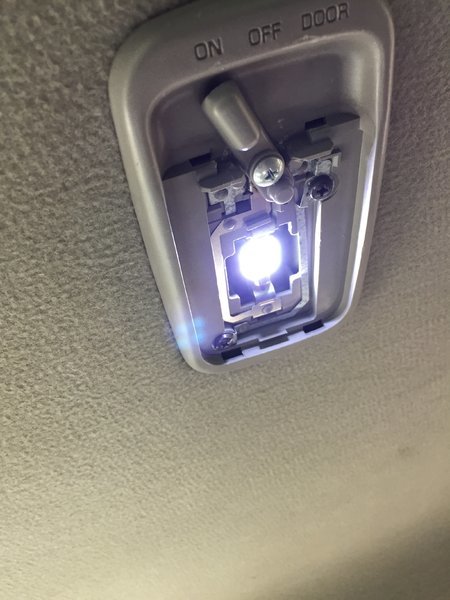

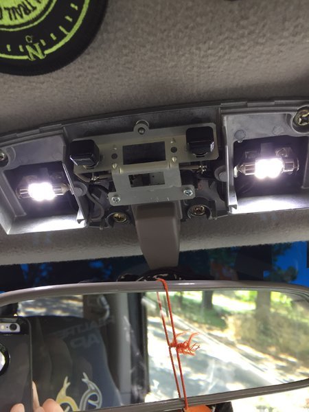

    I took this series of pictures to assist someone with the removal of the map light cover in my 04 DC. I struggled a bit initially, and didn't find any good references, so just in case someone else is struggling, here is how I managed to get mine off. Insert small screwdriver/knife blade as shown, and pry this small cover loose and remove.

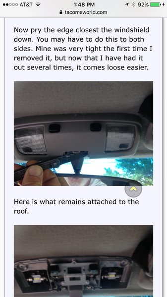

    Now pry the edge closest the windshield down. You may have to do this to both sides. Mine was very tight the first time I removed it, but now that I have had it out several times, it comes loose easier.
    Here is what remains attached to the roof.

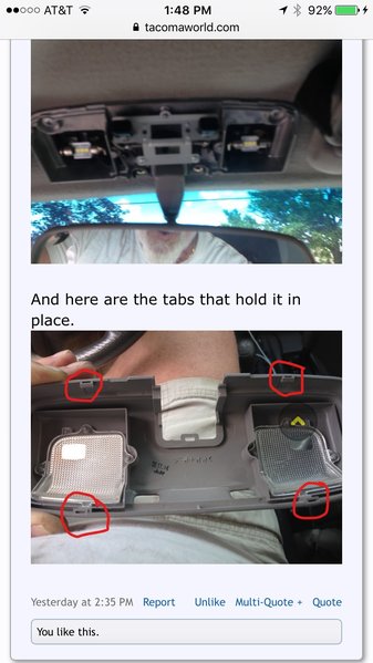

    And here are the tabs that hold it in place.

    Here are the pics. I screen shot them and posted for ya guys!

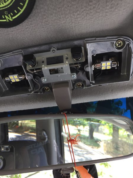

    I just replaced my map & Dome lights with LED's. Thanks again @Seagull233 This was the most easiest upgrade by far!

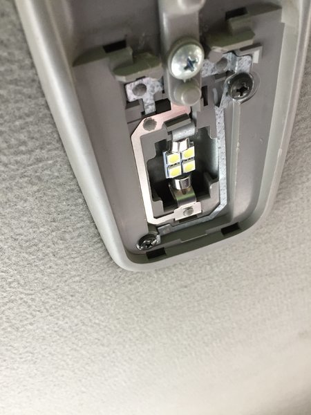

    Just installed LED light in my dome. All 3 positions work. On, off, door. But they only work with key in ignition in Acces, or on position. Once I turn the key off, the dome goes off too. Thought someone may have some insight to what is going on with it?

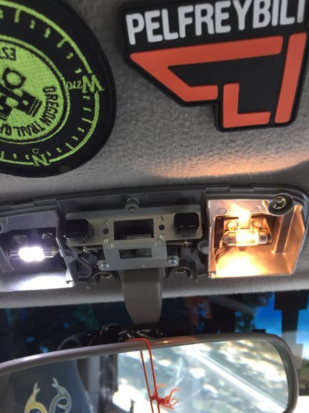

    Likely you will need to add a resistor to the dome bulb. That solved all of my issues.

    Is that a load resistor Seagull? So, you just sodder to both ends of the light? Thank you!

    Yes. 10 ohm if memory serves. The integration circuit just needs a tiny bit of resistance.
