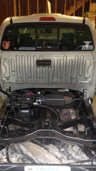

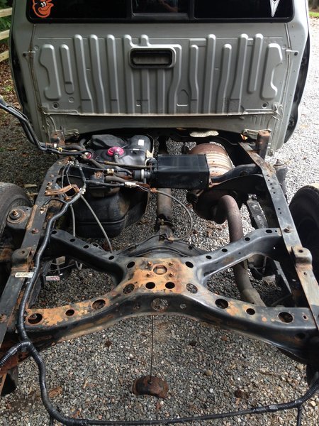

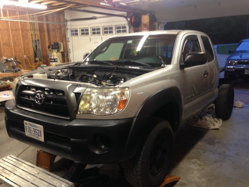

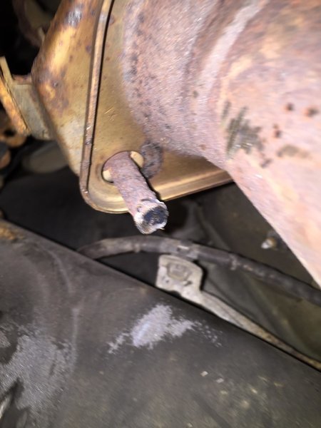

    Nice work on the frame. Don't forget to oil inside the frame. I use a rust proofing gun on my Tacoma.

    Thanks! Didn't think to oil the inside of the frame...I'll definitely do that!
    Update on engine removal: everything has come apart nicely. Only snag so far are the two rusted/seized exhaust bolts from pipe to manifold and top two transmission bolts.
