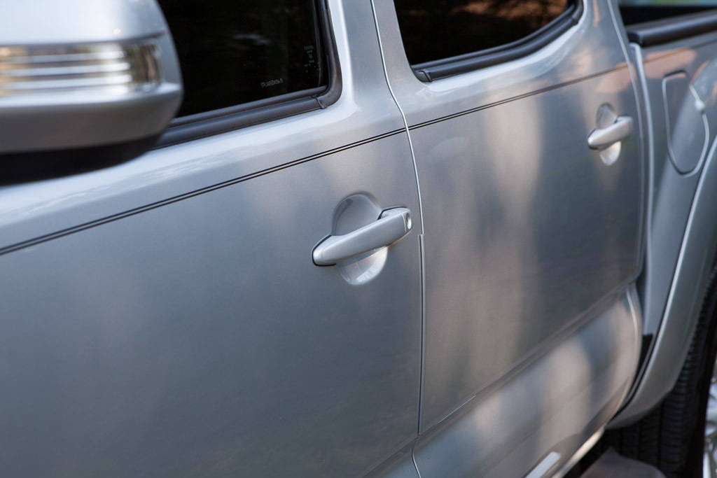

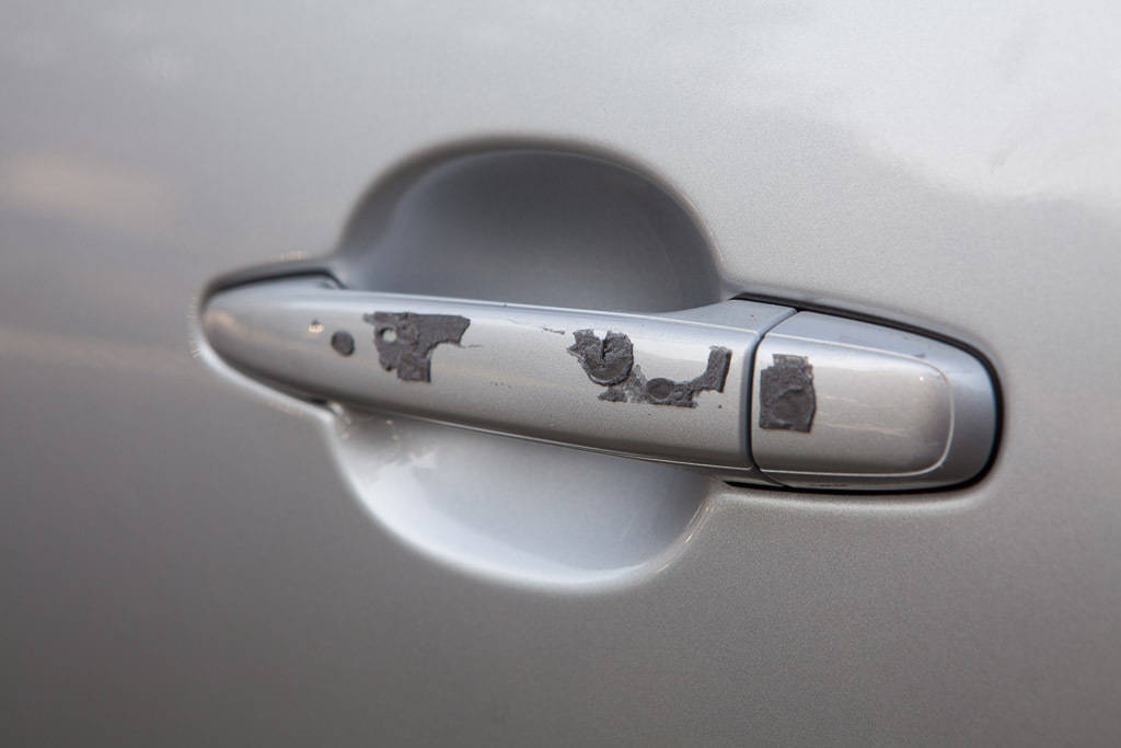

    Hey Chad. I did the same to my Tacoma. Owner before really liked chrome accessories. I just started pulling the chrome off. Most of it broke because it's just cheap plastic. What you'll most likely have left is some 3M tape stuck on the truck and the best thing I found to use it the 3M Adhesive Eraser Wheel. You can find these at most auto parts stores. Got mine at my local Advance Auto store. Just be careful when using the wheel. You can burn through the paint if you hold it in one spot too long. And use a nicer drill that has a variable speed trigger. It doesn't need to spin fast to get good results.
    3M tape left from pealing off the chrome covers:
    Nice clean results. You would never know the chrome was there.

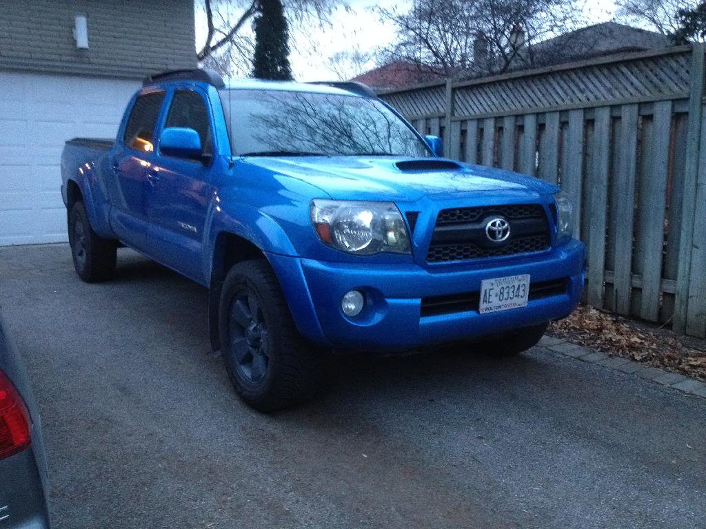

    The mirror caps came off easy... most of the glue had been removed already! Just one strip was left, a few seconds with the heat gun and it popped right off. Just used my nail to push off the remaining glue.. didn't need to use the 3m wheel.
    The handles were a bit trickyer, i used the heat gun to warm them up (it was around freezing, if it was a hot sunny day it wouldn't be necessary) and used a plastic trim removal tool to pry it off, working my way from the front to back. I used my thumb to roll off the big pieces of glue, then used the 3m wheel for the "hard to get" spots... it worked great!
    Everyone loves pics, so:
