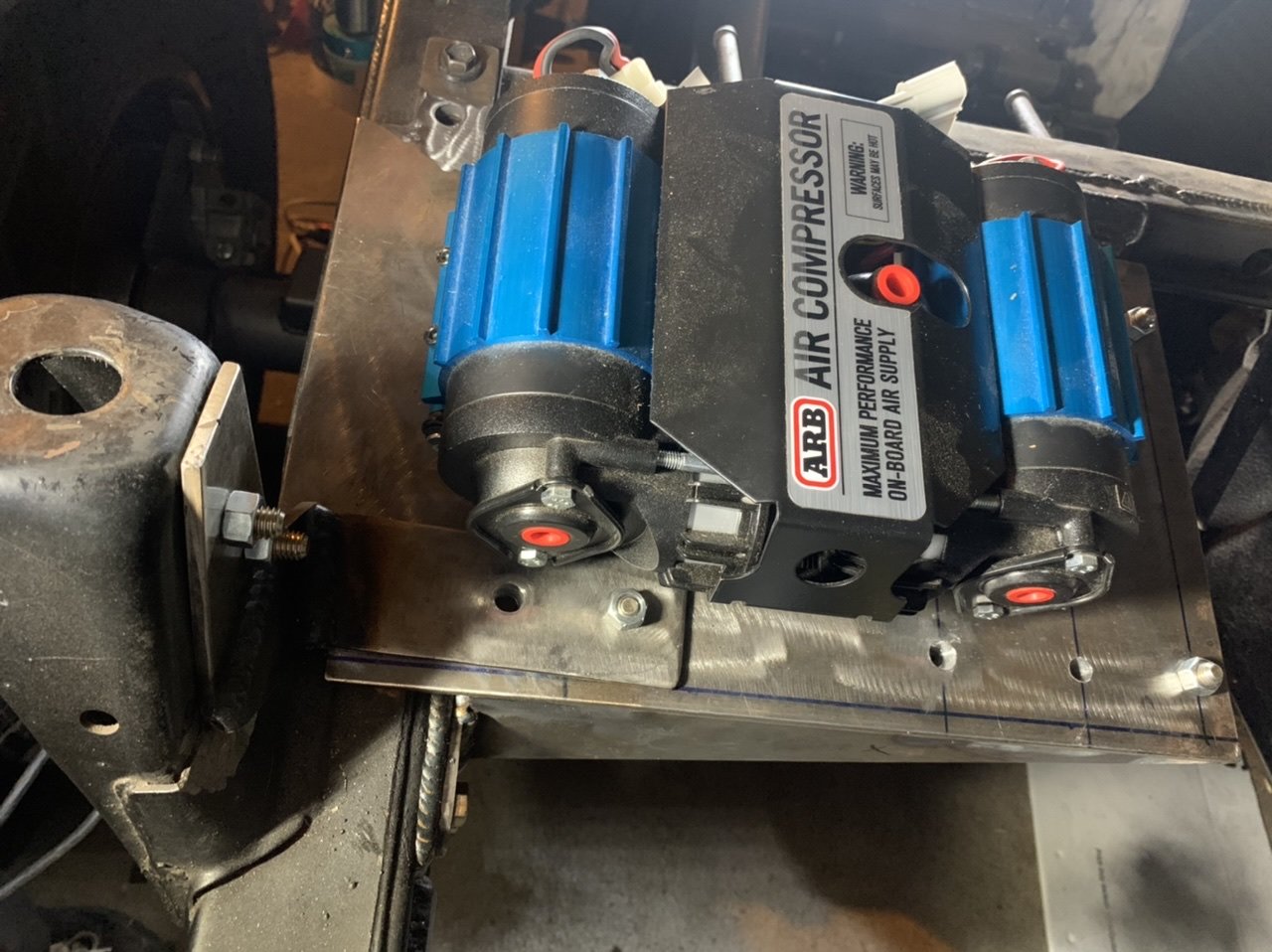

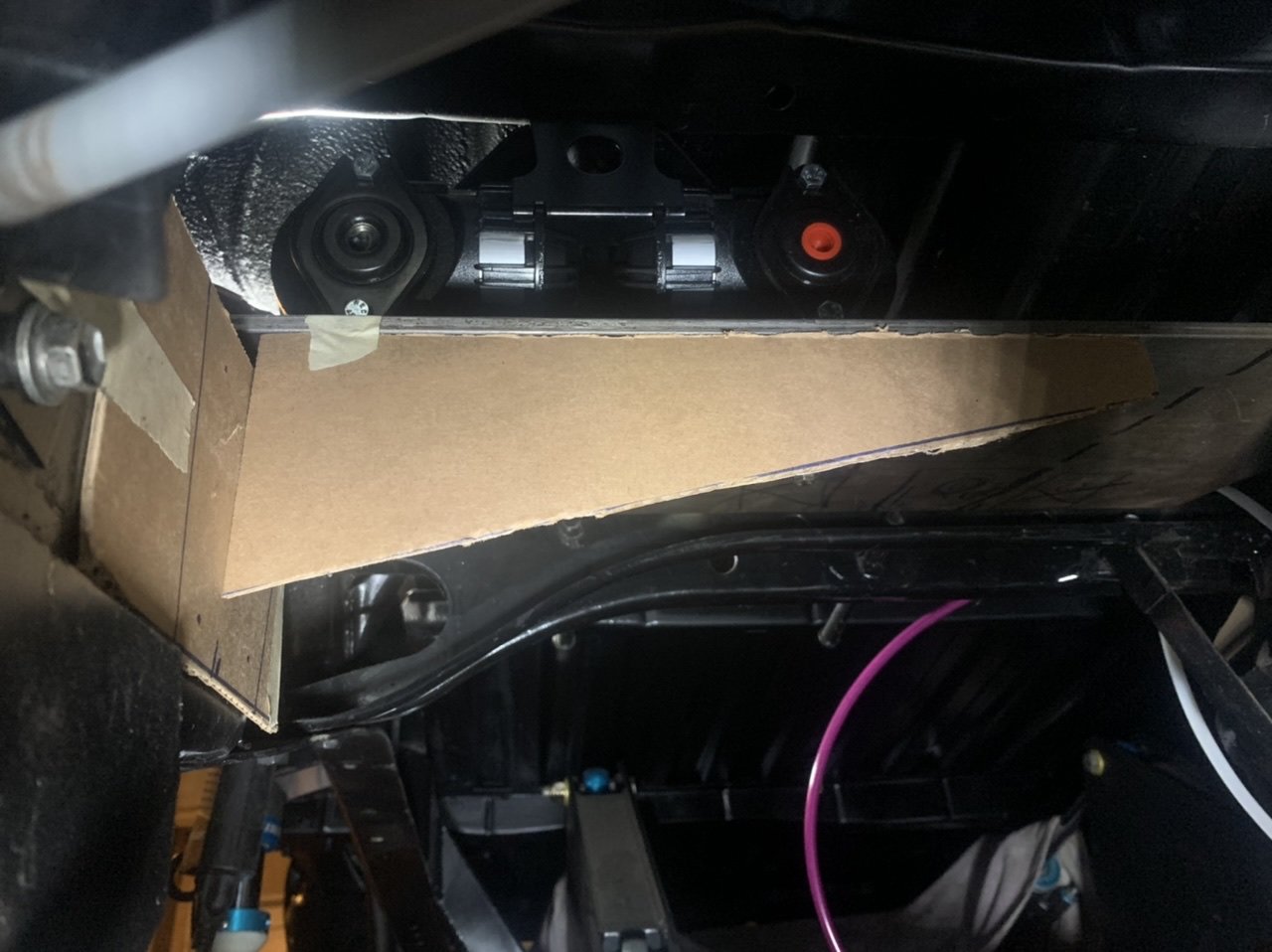

    Go with arb dual compressor for sure - the performance is more than double that of the single if you’re going ARB. There’s a nice spot for it if you don’t have a full exhaust under the bed so you don’t have everything crammed up in the engine bay. It requires taking the bed off while fabbing it, but fits nice for sure and the intake could be run up between the cab and the bed or into the cab.

    have the dual sitting in my shed ready to go in :thumbsup: definitely gonna look into that spot, have to pull the bed for fuel pump upgrade for the supercharger anyways. Did you route the compressors’ intake up higher?

    Yeah since I removed my bedsides to put fiberglass ones I can run it up under the bedsides and under the fiberglass “bed rail” through a spot up by the passenger side top corner it will fit through. Stock bedsides could still work with some light modding for sure.
