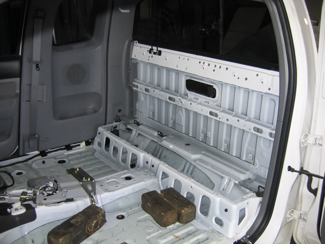

    Hi. Does anyone have any ideas about removing the hokey seats/storage setup in an '06 Tacoma Access Cab? I could use the space a lot more productively for locking tooboxes that actually have some capacity, with a level deck covering them and any remaining space behind the seats.

    Everything just screws in place. What issue are you having?

    I haven't pulled it all apart to see, but I believe there's a steel framing bulkhead in the front of the seat/storage area thingie. Maybe the solution is to remove the seat and the storage bucket, mount tool boxes directly to the floor forward of that, and then build a deck with flip-up sections on top so you have a level area back there with easy access to the present under-seat storage area and to the toolboxes.

    OH! I thought you were talking about just pulling the plastic and cushions. Makes more sense now. :)
    Yes, there's metal. Rip stuff out and get to cutting. Here's my '06 access cab early on in my build:
    Piece of cake to get rid of. It's just sheet metal.

    As long as the sheet metal has no structural value, sounds like the way to go. Thanks for the picture!
