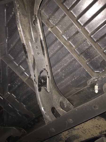

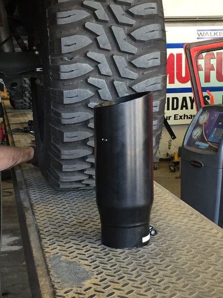

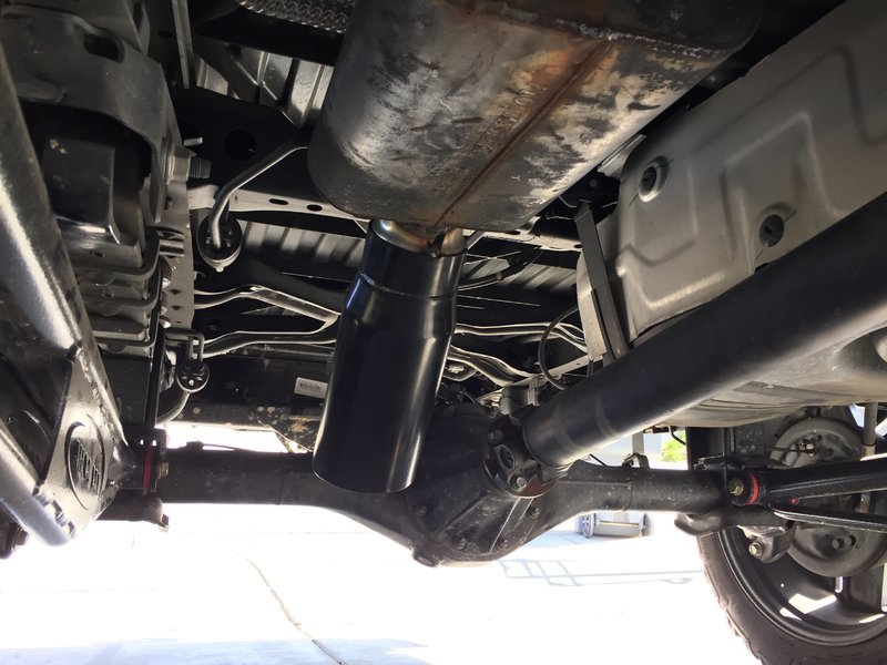

    So today I hammered down these spare tire guide tabs with a dead blow hammer. Then I went ahead and did an exhaust chop. Chopped off the exhaust after the muffler and added a turn down aftermarket tip. Got plenty of room now. Will be putting my spare on tomorrow.

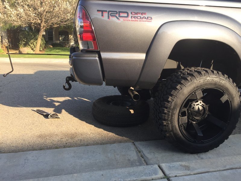

    Boom! 33" spare with plenty of room!
