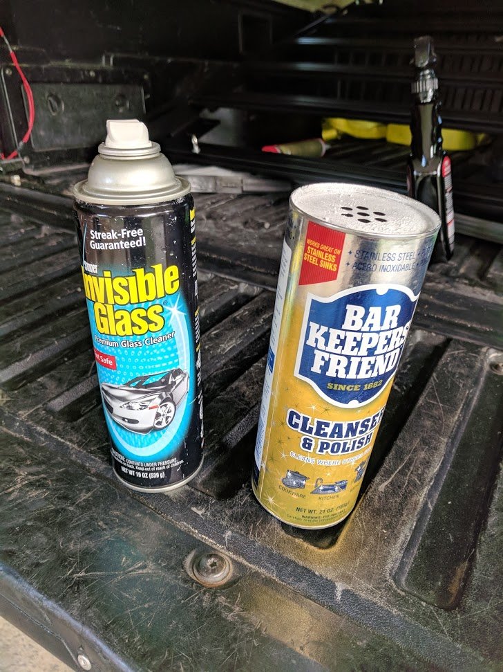

    Materials Needed:
    1) BarKeepers friend (I like the powder but the liquid stuff works too, I think the powder works better)
    2) Water
    3) Window cleaner (I prefer invisible glass)
    4) Sponge (I use the scotch blue ones that are scratchless, or one with the netting on it, do not use the green ones too rough) I have heard that 0000 steel wool is ok but have not tried it

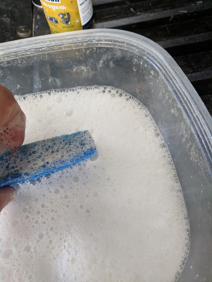

    5) Small container to hold BarKeepers Friend and water mixture in
    First gather your materials.
    Next create a slurry of water and bar Keepers friend. This is roughly 4 tablespoons of the powder and 2-3 cups of water. Note: you will have to continually stir this as the powder tends to separate from the water.

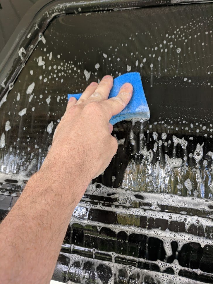

    Then spray your windows with the window cleaner this acts as a lubricant, similar to when you are wet sanding.
    Next start scrubbing. I use the soft side of the sponge and save the rough side for really bad spots. This takes some elbow grease and may take some time.
    I scrub in all directions up & down, side to side, and Mr. Miagi wax on wax off. Scrub until the window feels smooth. If you are getting water spots off you will have to rinse the windows off and dry them to see if you have gotten them all. If you are not satisfied after rinsing and drying wash, rinse, repeat as many times as it takes to get them clean.
    If your Bar keepers Friend mixture is too heavy on the powder side you scrub too hard with the rough side of the sponge or whatever you choose to use, or you put the settled clumpy powder on the windows and scrub you run the risk of scratching the glass.
    After you are finished make sure you rinse the windows and truck well the slurry can leave white streaks on the truck. I also dry my windows then use the glass cleaner to make them shine when I am done with the slurry. I usually like to do this when I know I am going to wash the truck because like I said the slurry likes to leave white streaks so why not go ahead and wash the truck and know you washed it all off good.
    Hope this is helpful any questions please ask.
