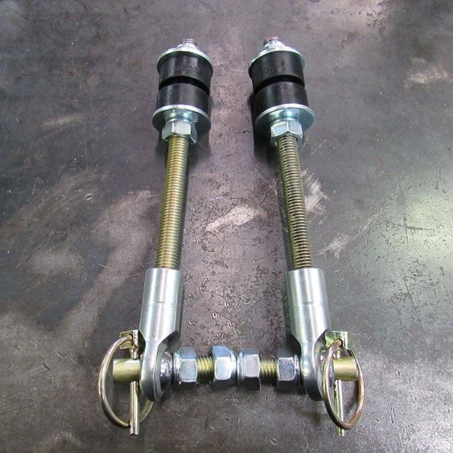

    We could run these on 3rd Gen tacomas, right? But have a wing nut on the top instead of the standard lock nut. Where'd you get these?

    I don't think you can disconnect without removing entire bar due to CV damage. These are on my 4runner and made by Wabfab. I would look into a member named @mstudt. He makes them for a lot of toyotas.

    805
    SD, CA
    Okay, now I get it. So even if you disconnect and remove the vertical sway bar link, the black horizontal sway bar will damage the CV.
    So now we need another bracket to attach the disconnected sway bar to... hmm.

    Considering the stock bar. Both end links need to be released and the bar would need to be secured as high as possible to not make contact. That last part is the trickiest as it could drop down due to trail vibrations.
    There was someone considering a mod that would shorten one end of the bar, so only one end link and a two bolt connection on the modded bar would need to be removed. That is risky from a strength standpoint, but a failure should not cause damage.

    The Taco is a bit different with two ball joints on the end links.
