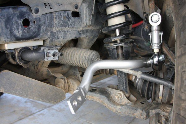

    You can not disconnect the sway bar without causing damage. The design of the sway bar will not allow you to swing it up out of the way. The sway bar itself will not clear the coilovers.
    You have a couple options for a disco on the front still. I build a sliding disco for 4th & 5th Gen 4runner as well as FJ Cruiser's. These give a disconnected feel without being truly disconnected. You can also build a sway bar disconnect that'll allow you to remove one side of your sway bar while leaving the other side attached.

    ^^ this is totally different than quick disconnects we are used to seeing for 4Runners. This doesn't disconnect the end links. This involves cutting the sway bar itself, and uses bolts/nuts to hold the bar together for on road use. When you want to go offroad undo the bolts/nuts (with the end links still connected) and the two sides of the bar can move up and down freely (instead of binding the bar and reducing roll). I'd bet this would definitely solve the problem, but I wonder if it makes the sway bar stiffer than stock when connected and cause harsher ride on road.

    This is what needs to be done on the Tacoma in order to disconnect the sway bar. This design has been used on the FJ's, and 4runner's for the past few years. I've thought about making a parts kit for this kind of assembly, but haven't gotten around to it as of yet. If there's interest in it I might be able to come up with something sooner than later.

    It's not that easy. This isn't something that in production anywhere, or at least not that I'm aware of. This was made for someone on the FJ Blueroom Forum, and that's it. I've thought about producing these, but never did due to now knowing what the interest would be. This is something that I would consider making after 1st of the year though.
