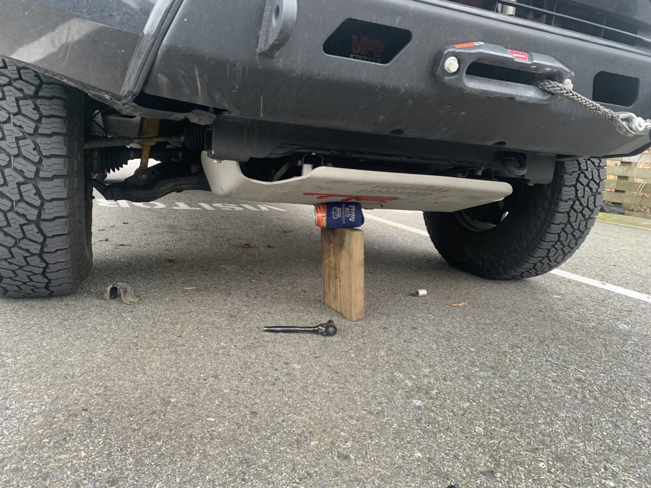

    After almost 5 years, removed my sway bar. Damn that thing is heavy! Only drove in the city and so far I really like it. I’ll take it out on the highway tomorrow and post a review.
    Had the best helper!
    JoeCOVA likes this.

    So drove around some more, didn’t get a chance to go on the highway though.
    Did some sharp turns at 50 or so MPH and it felt fine. A bit more body roll but I didn’t feel unsafe at all.
    My only regret so far is that I waited almost 5 years to do it. By the way, I’m running 2887 OME coils and nitro charger soft valved shocks, 2” lift.
