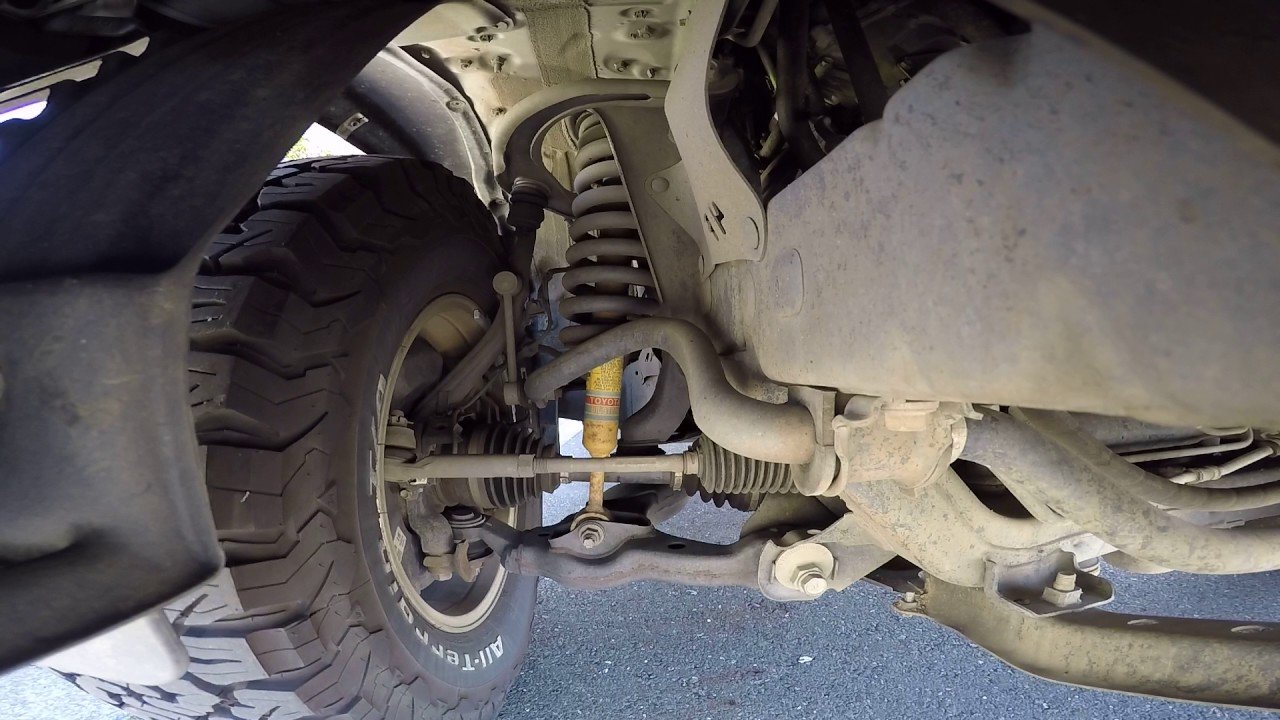

    That's a bad idea. The free end on the 3rd Gens will hit the CV.
  16. May 20, 2019 at 2:11 PM
    #16
    tonered
    tonered bartheloni
    Sep 25, 2017
    #231055
    31,167
    tony
    Lynnwood, WA
    The end links on the 3rd Gens is in line with spindle. Not the best pic, but it give you an idea:
    Just for the record, I'm in the delete camp (SBD), but I have a nice stiff Sport.
