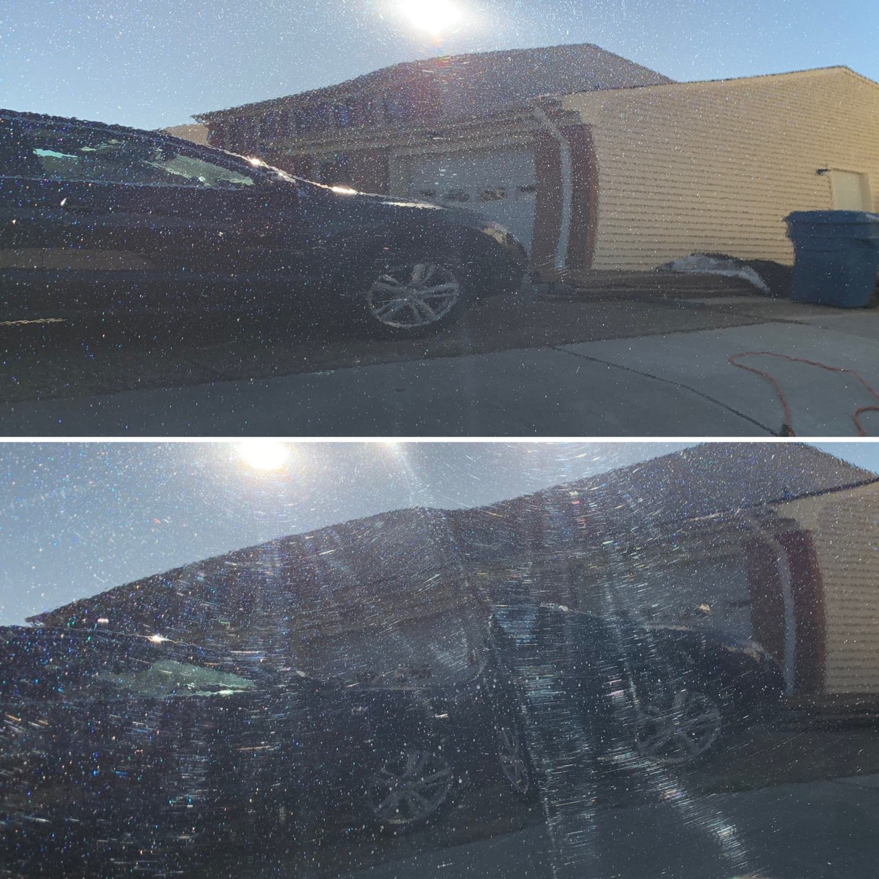

    okay, some of this is the pic. The whole door looks like it’s scratched. If you want it to look new, OP, you need a professional. If you just want to clean it up, Technically_simple nailed it.
    it’s been a bit since I have done this but I believe it’s scratchx or swirlx by mcguires that is just a touch finer than their compound. Use the compound first, then the [whatever it’s called]x followed by a good polish since you have a bit darker vehicle. Just use waxing pads, you don’t need a polisher. I used to use this on my M3 and it worked like a champ.

    My cat put some minor scratches on my hood literally the 2nd night after I bought my truck. They aren't near as bad as the car wash swirl in your pics, but for minor scratches, I picked this stuff up and it works pretty well. Sorry, but I didn't take any before or after pics.

    Sorry, but if anyone thinks you can remove these types of swirl marks by hand, you are sorely mistaken. That, or you have a bionic arm.
