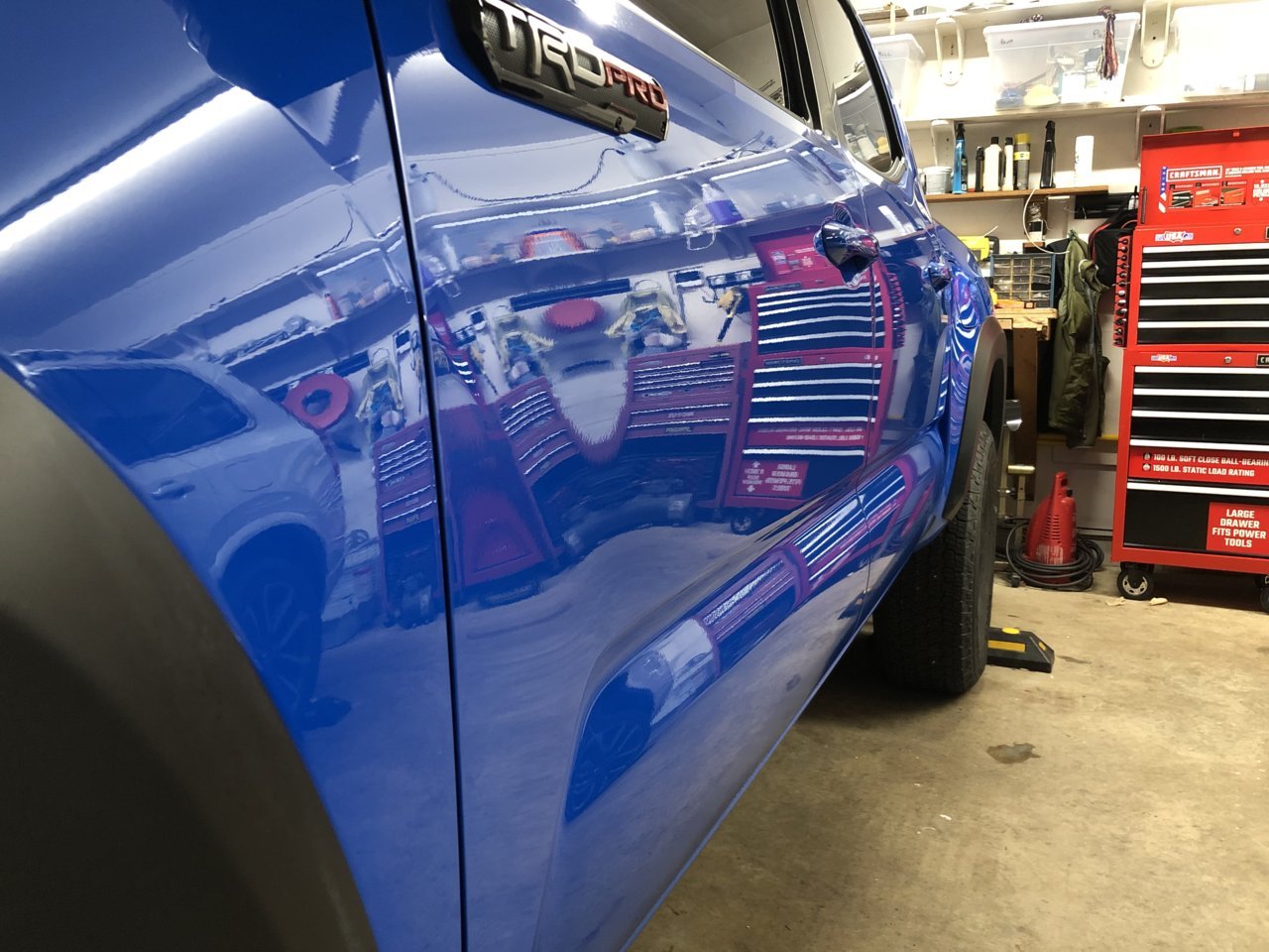

    Update: Amazon screwed up my order, so I went to Harbor Freight and picked up a (random speed) DA polisher, an orange and white pad and Meguiar’s polish.
    Took me a few hours to get the hang of it, but I was able to remove all of the damage on the driver’s side so far. I hit it with 105 and followed with polish.
    In the midst of my intense focus, my Malinois got tired of waiting for me to let her back in the garage with me. So she decided to take herself on a walk. What’s funny is it was the same path and direction we normally take.
    After looking for her for 30 min with the help of my neighbors, she strolled back up the driveway with a “I don’t need you for anything anymore, f*cker” look on her face.
    Anyway, I appreciate everyone’s help. The Junkman video really helped.

    Finished. Used 4 different products. Truck looks better than the day I bought it

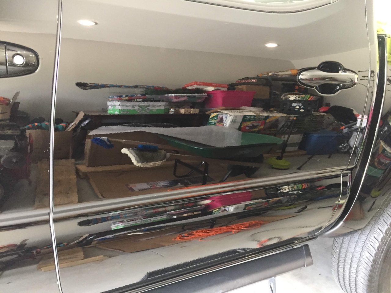

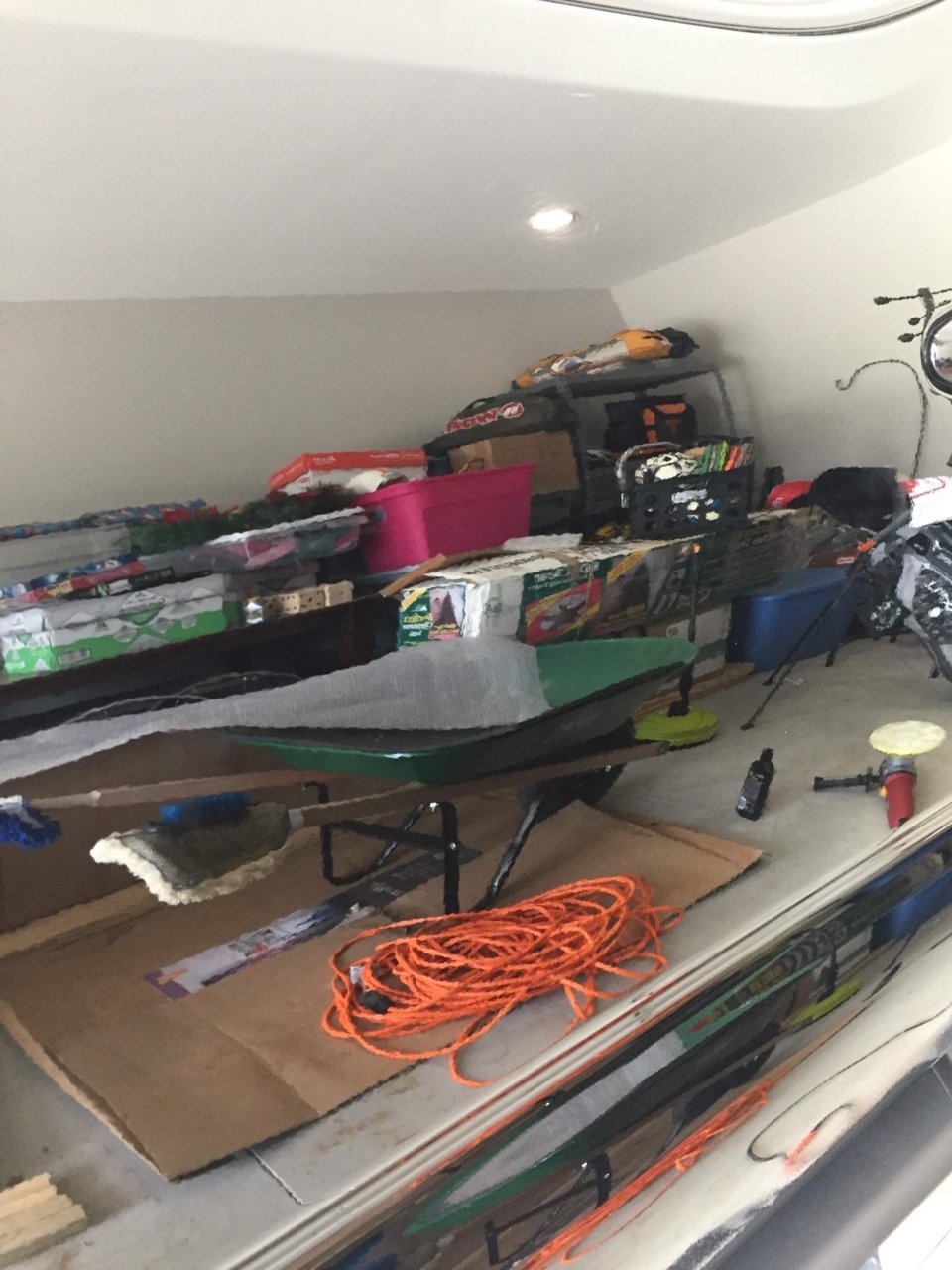

    It's so satisfying once you get that mirror finish (ignore the mess in my garage, we had just moved in)
    This is my process -
    Foam Cannon pre-wash
    Two bucket wash
    Iron Removal
    Clay Bar
    Isopropyl Alcohol
    Polish with DA polisher
    Wax/Ceramic coating

    Truck looks good! Glad you got those swirls out. The product line up. Is that the order you used it in? I'm assuming that harbor freight da polisher worked ok? Awesome job man.

    Man you could shave using that door..lol
