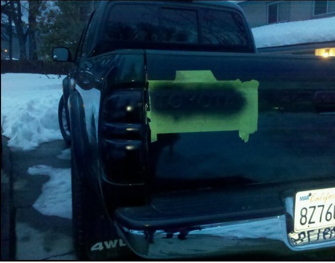

    do you have any pics of the rustoleum tint? I would like to see what that looked like.

    Yea I think I have a couple I'll put em on here in a lil bit when I'm on my laptop.

    Doesn't really show much but this is all I got:
    I'll be re-tinting tomorrow though so maybe I'll post a few more pics for you.

    thanks...........they look really dark. How did they look when parking/driving lights/brakes turned on ?

    That was with three coats, the lights didn't show too well. I re tinted again yesterday evening and did two light coats and it looks way better. Light output is a lot better than the last tint, the lights were very visible during the daylight today.
