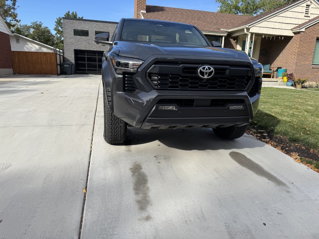

    I did not like the unfinished look either, so when I was cutting up the big piece of plastic to put it in my trash bin, I had a moment of inspiration. I cut the entire thing down to about an inch and reinstalled it. I think it looks much better!

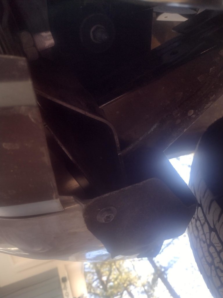

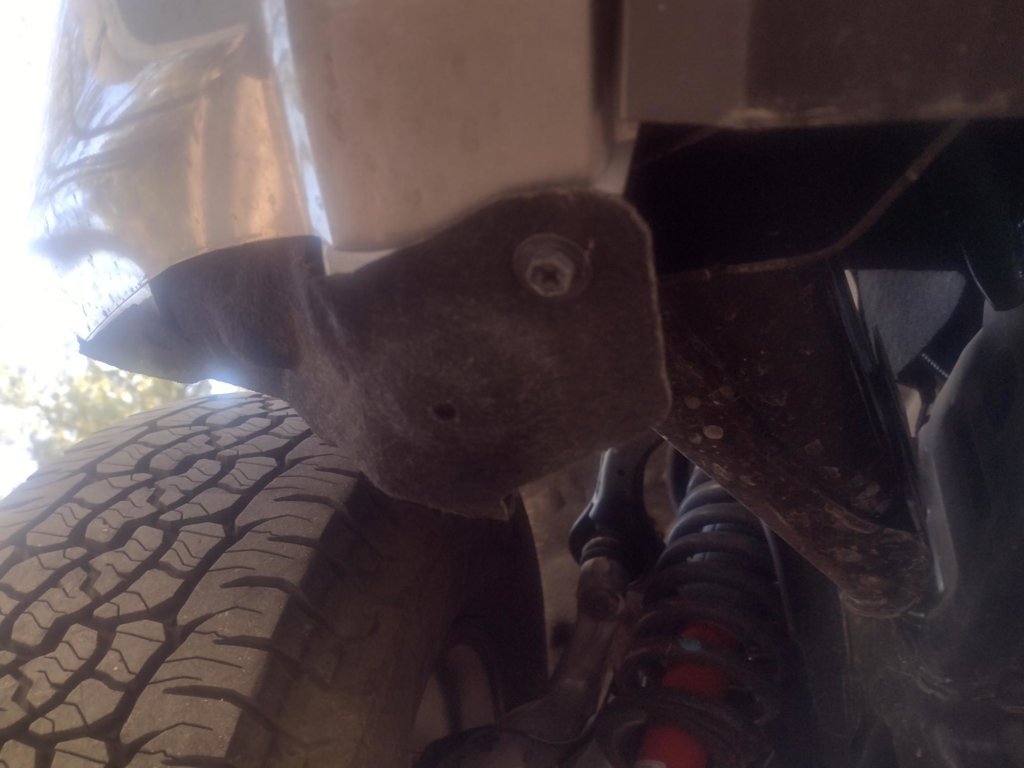

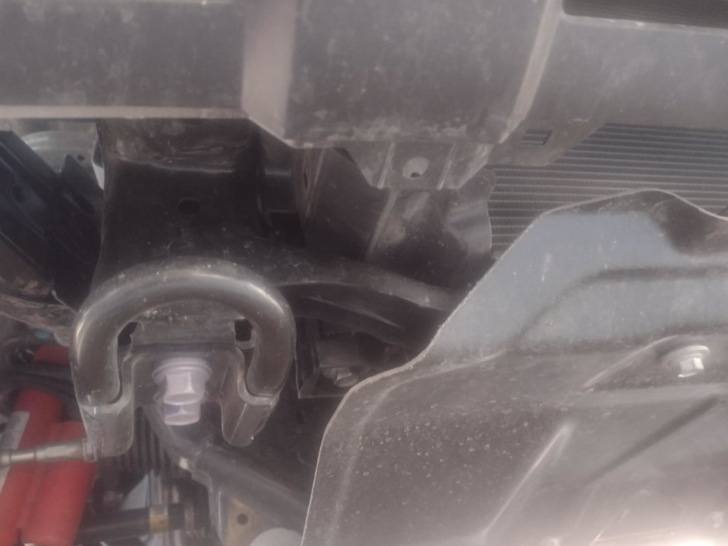

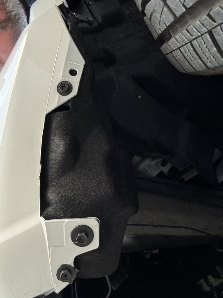

    I just put the felt on the inside of the bumper and put the screws in. Was not that complicated.

    OK, this is both simple and brilliant. I can't believe I did not think of this...

    Don't feel bad, I didn't either. I saw the one extra screw to take out and was like naw... Then I saw the picture and this is the only way. Easy and looks 100 times better. I also trimmed the middle section to about an inch and bolted it back up.

    Checked your pics and it looks great. What did you use to cut those smooth lines? I was debating a router or jigsaw before I start hacking away

    Thanks! I just used a jigsaw and a file to smooth it out. One area got a little ugly, so I touched it with an angle grinder.
    The pics might look better than it looks up close and in person. But I doubt anyone will ever even notice it...
