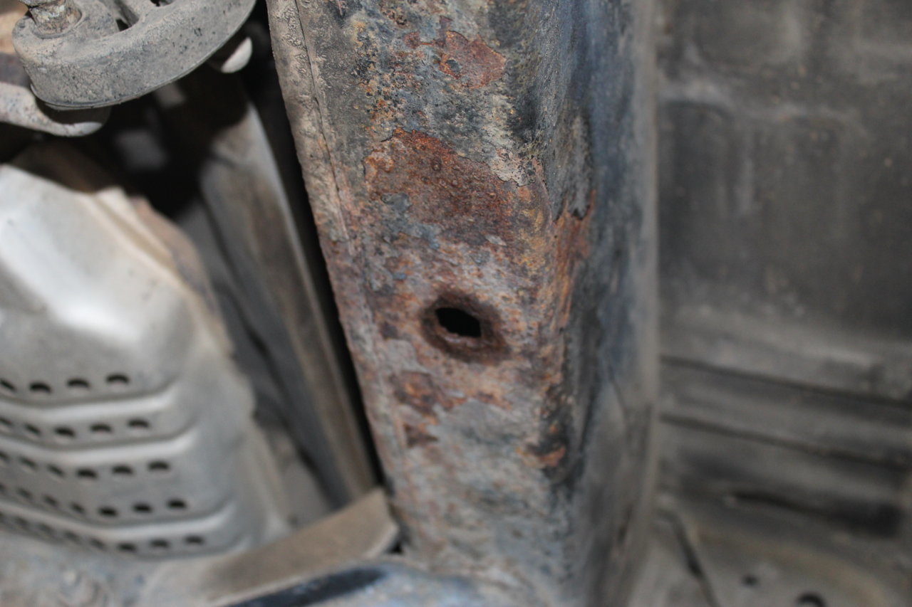

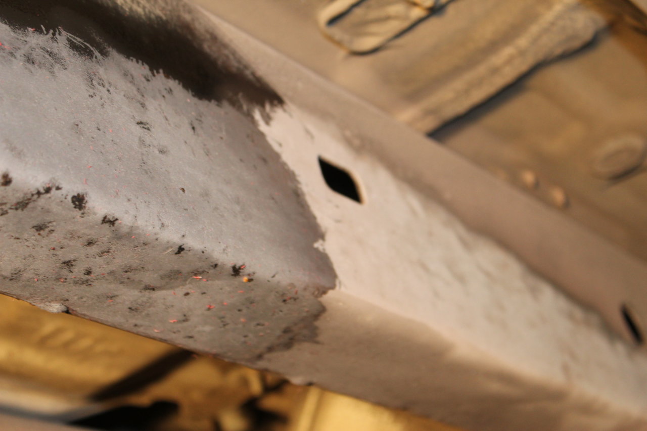

    Day 3 .... over a month delay in any progress but getting back to it before weather takes a cold and wet turn again
    cold and naked toyota steel removed of crust and most bad paint by the cat
    what this area looked like before blasting procedure, underneath 2+ decades of rubbery coating this was found
    i am getting stoked :cool: already to put the afterblast zinc coating and a couple coats of extreme primer (weather permitting)
    the winter monster will not take this from me, i refuse :duel:
    ... using black aluminum oxide as blast media, its much easier to clean driveway as compared to glass bead 'sand' stuff last month

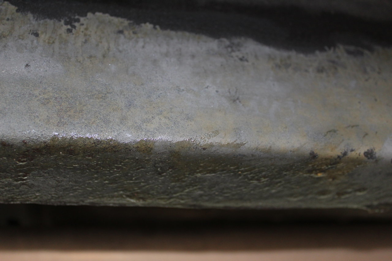

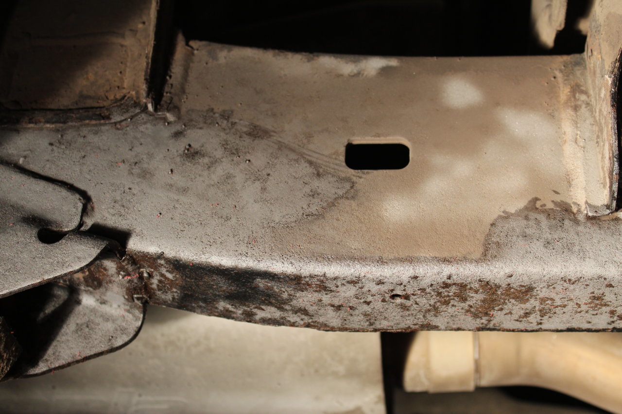

    ok, this is from the passenger side, about mid truck, on the outside of the inner frame (confusing way to say it)
    Halogen lamp focused on it to make it more intense
    I'm not sure exactly what to say here..., after wiping off the blasting dust with wd40, the paint appears ok on the outside, not a whole lot of bubbling at a quick glance (just on the lower portion) but a closer inspection after blasting the bottom edge revealed this creeping behind for who knows how long. This part was not chip coated with undercoat rubber spray when i bot it so not sure if this started with tiny gravel chips or winter roadspray up under there just seeping through the paint or what
    it seems pretty widespread to be just gravel chips :notsure:
    ... suppose i gotta blast up as far as the top now!

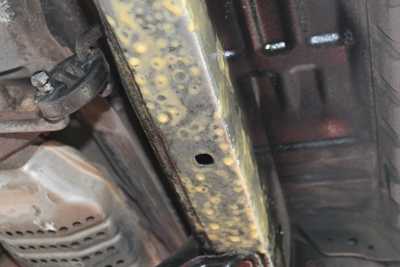

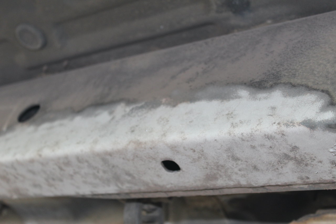

    alright, after 7 dirty hours this is one section i got partially finished before it got dark and cold
    wiped the afterblast product on with a new red shop towel from HF (it left red chunks behind so I will not be using that again!)
    and wiped off until white rag was clean and free of contaminants. the silver part is the zinc coating
    I left the other section naked and hosed the driveway off, which will probably induce flash rust to clean up tomorrow which is what I want and try the afterwash to clean that stuff off and see if it works or not.
    the scattered black spots left behind i suppose are still paint that I could not see through the saftey glasses and face shield, even with the halogen floor lamp pointed up at it!
    perhaps there is an easier way to get that all off and a smoother surface for the primer when the weather cooperates
    i have an electric angle grinder somewhere around that i have not touched in awhile, perhaps get a sanding disc and see if that will work :notsure:
    this area needs more done tomorrow, bring on the flash rust
    ^^^ i will need to re-blast this area again

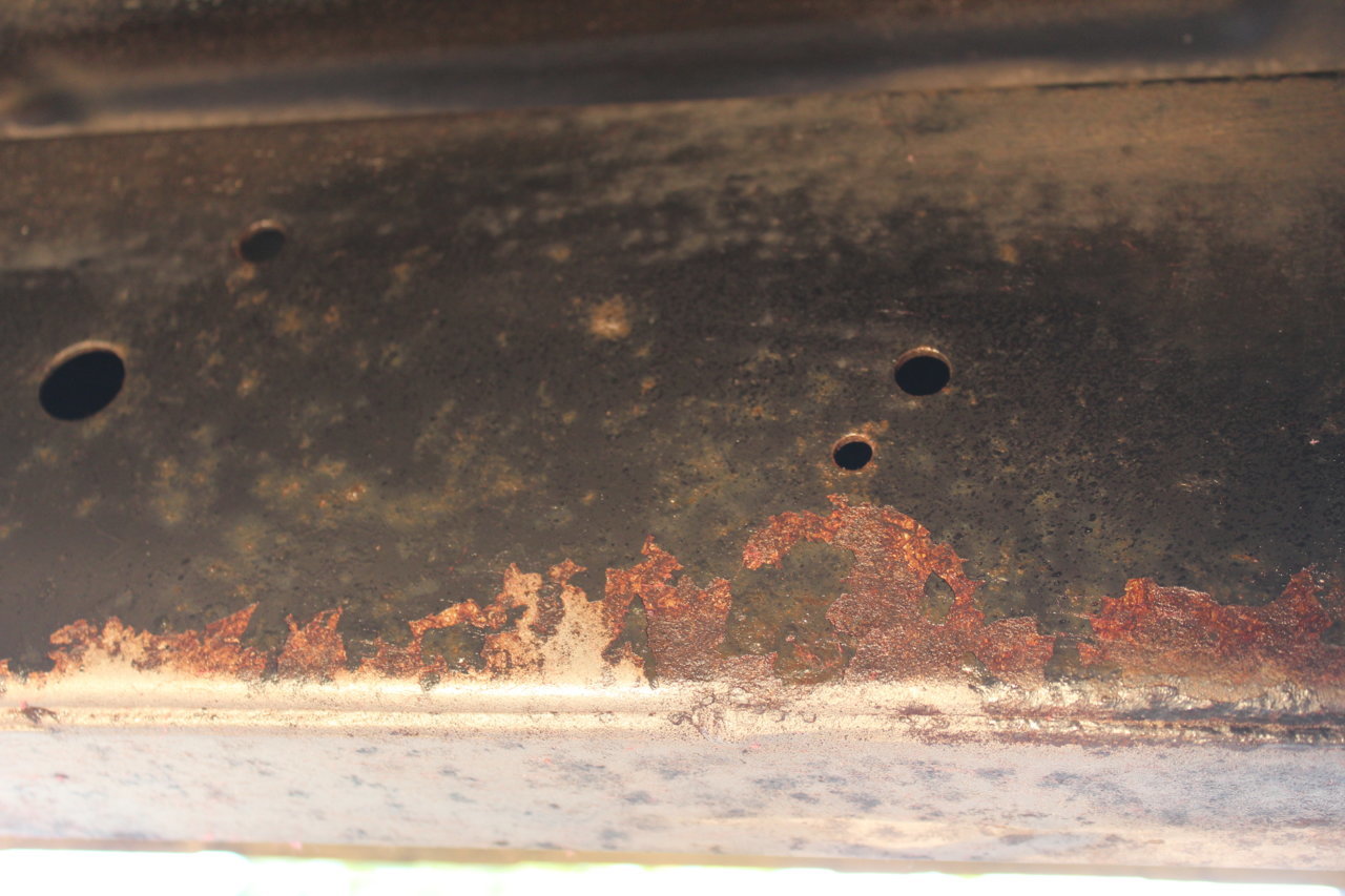

    Day 4 .... i may or may not have made a very big error here
    with fluctuating weather forecasts over this coming week and chances of rain on the weekend i cannot get on the road with a naked frame and flash rust up the what on my way to Des Moines.
    i went ahead and coated and wiped all blasted bare metal with the after blast zinc coating until the white rag was clean and then poured on the Fluid Film product for the very first time
    there are still a number of spots i need to spot blast such as this by the cat on the inner edge, some say the FF will be difficult to properly remove to primer and paint but i don't have a clue yet about this stuff

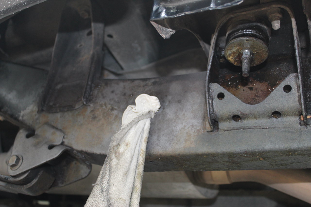

    the weather has been a bit too cold lately to paint properly and neck has given me issues being super stiffened up ... damned old age i guess
    i have run the truck through the auto wash with undercarriage spray (to see how well the FF drizzle has held up) about 7 times now
    ... have not noticed any flash rust yet under the FF and zinc phosphate coating, but definitely not winter ready yet!
    ^^^ i need to run the blaster over this area again when weather gets warmer before i can primer it
