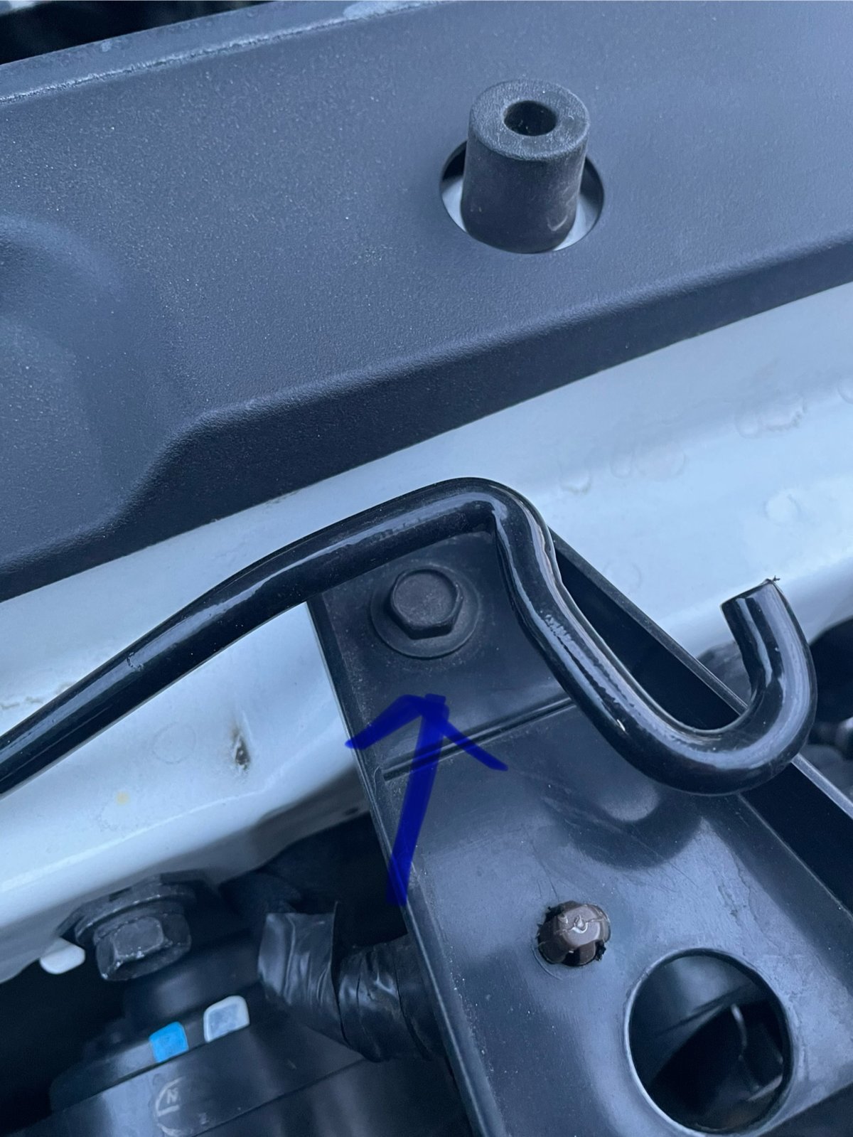

    ‘21 OR here so not sure what the differences may be, but I think mine had 2 10mm bolts on the outer edges and then 4 or 5 of those push in, then push the center in plastic connectors.
    Seems like the bottom had heavier duty plastic “clips” that had to be engaged first and then the top.
    I’ll get you some pics if you want, just let me know.

    The bolt pictured is on the driver side in the larger black piece of plastic- another on same piece on passenger side.
    The clip pictured is on the pass side- same thing on driver side but dog chewed that one and I haven’t replaced it.
    I said earlier there were 4 or 5 clips, but didn’t see any more than the 2 just now.
