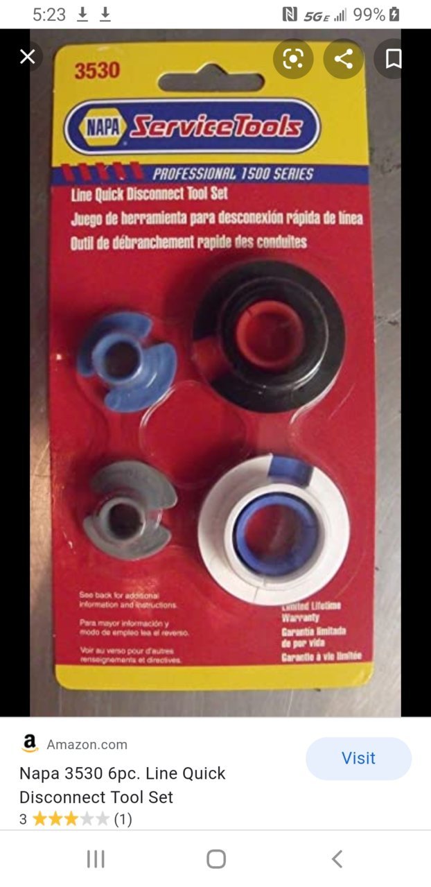

    If the ford ones are like the chevy one on my old astro, yes they take they special plastic tool that slides in.. there are other backwoods way of doing it with 2 small screwdrivers but I always bugger the clips up when I try that.
    NAPA sells a mutlipack of sizes that I bought and use

    thanks....i do have a ford tool here somewhere. Its probably a completely different size. It sure looks different than the ford clips i have removed in the past.

    Definitely a different size than ford, but not sure which... this I the kit I bought and was on the shelf at my local NAPA Screenshot_20200701-172309_Chrome.jpg

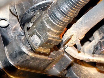

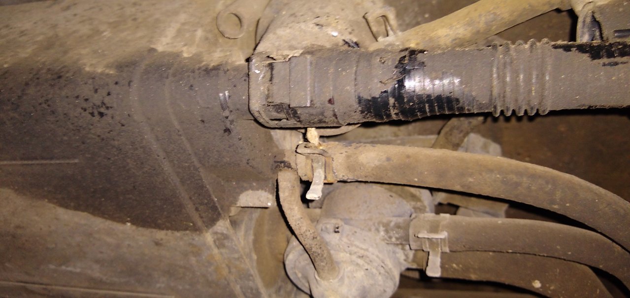

    This is a tacoma, its all flare nuts to my knowledge

  8. Jul 1, 2020 at 6:13 PM
    Black DOG Lila
    Black DOG Lila Well-Known Member
    Jun 14, 2019
    #296344
    9,116
    Virginia
    2003 Tacoma SR5 2.7 5 speed 4WD
    Stock. EZ pass.Dump pass.Inspection sticker.Convict printed lic.plates.FG cap.

    Thank you for correcting me! I love everything I learn on this site

    no idea where the canister connection came into the conversation. The link clearly shows fuel lines with the re tab but thanks for the info on this as well.

    Was hoping to inspire you to post pix on your threads.:thumbsup:
    No, I will not be teaching you how that's done. :help:

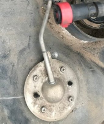

    Your post didn't say why you were pulling the tank. If you are replacing it, check to see if the one you buy will come with the housing for that little vacuum shutoff valve cover shown in the pic. I bought a tank from Rock Auto and it did not come with that piece. I never could locate a source for one. Mine was rusted to pieces, so I ended up making a new one.
    You can buy the valve inside, just not the metal cover. My trucks are both 95s so maybe you can still get one for your truck IF there are any difference in the part between our model years. It looks identical though, so....
