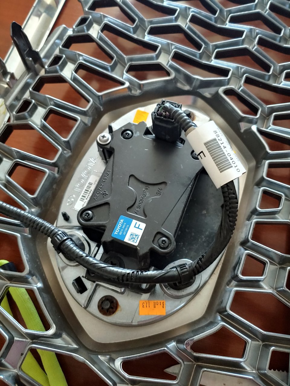

    Are you are referring to the clear plastic "dome" over the logo? This cannot be separated from the logo without breaking it. We make a decal that goes over the logo without affecting the TSS radar that is embedded behind the logo. Send me a PM for details if you are interested.

    It’s a bitch. Take all the screws out and half of the clips on the back are for that surround you want to remove.

    Here's a pic if that helps

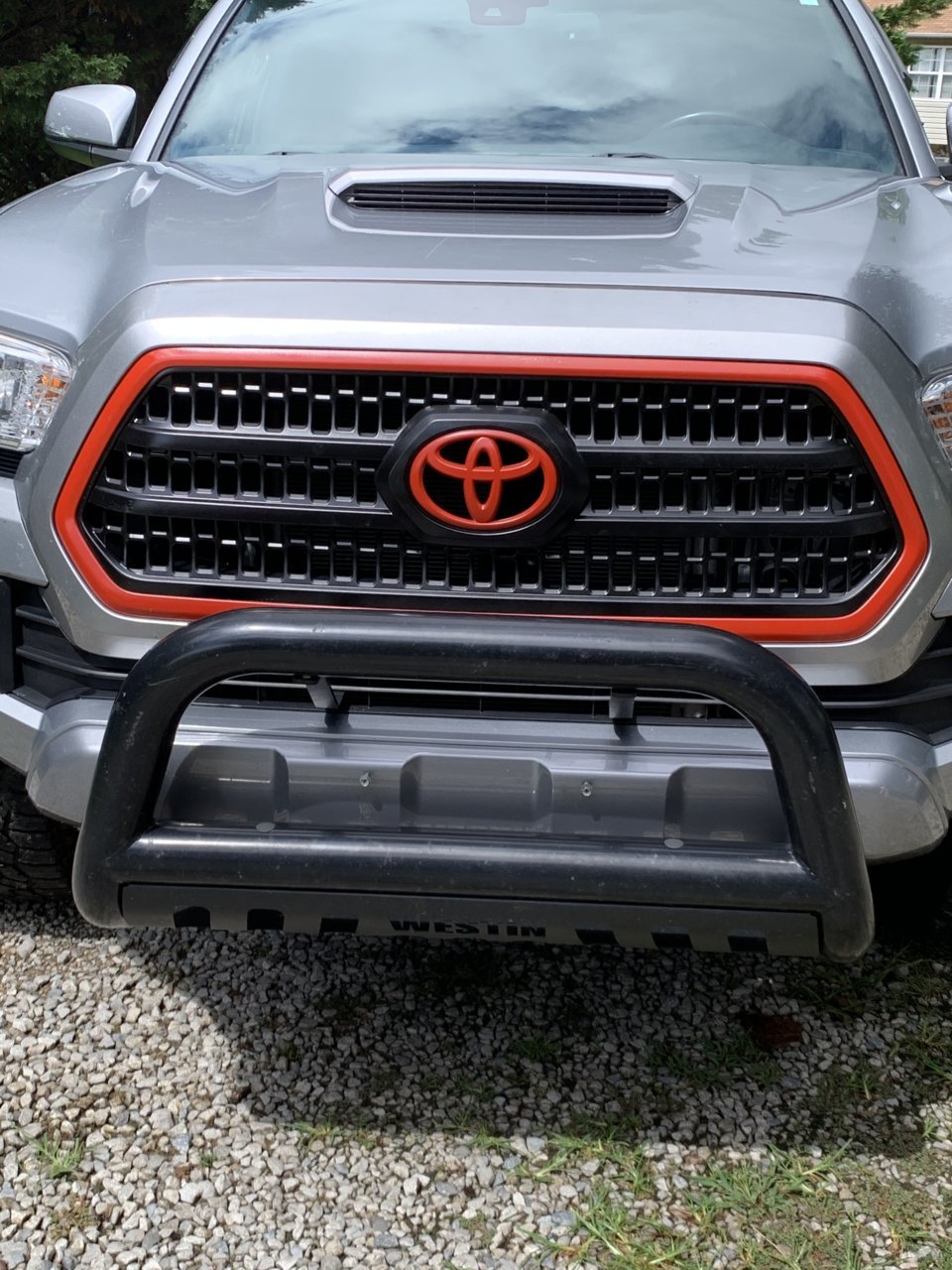

  13. Aug 18, 2021 at 10:35 AM
    TacoSalad119
    TacoSalad119 Active Member
    Jan 25, 2021
    #353983
    29
    18 TRD SPRT M/T
    I know this is old, but I ended up just buying a used spare grille assembly off marketplace and painted it myself. Then I just swapped it out with mine. The only difference is I have the pre-collision sensor disabled now. It’s not a necessity for me, but may be for others. I wanted rid of all the tacky chrome as well. It turned out decent, especially for about $30 total in grille assembly and paint.
