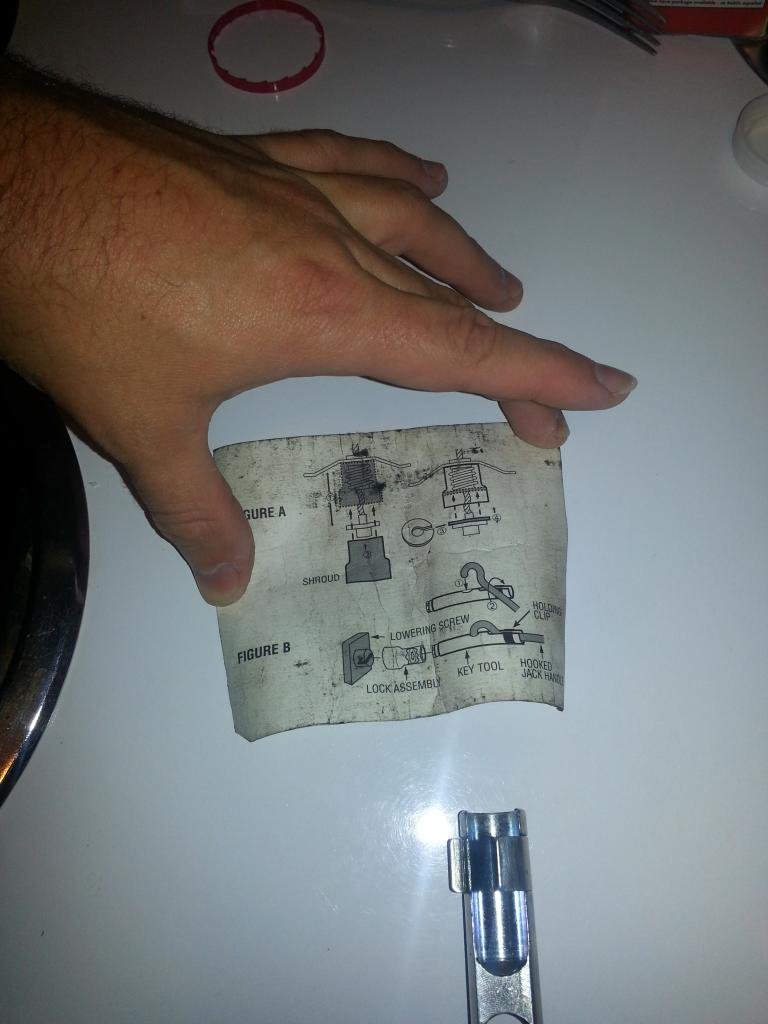

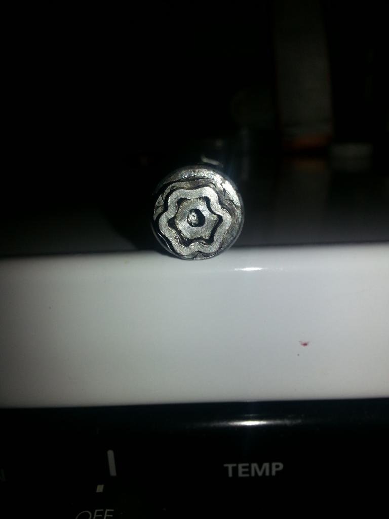

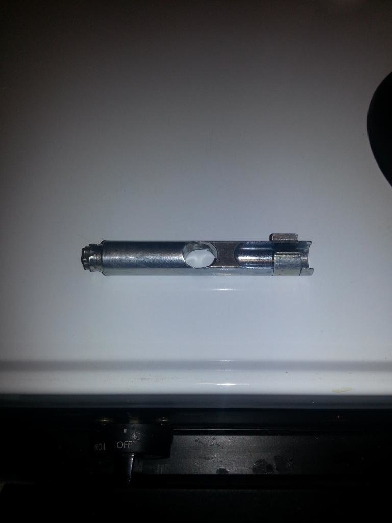

    Nevermind, I used a piece of pipe with a small flat welded in the middle. Here's another users picture of what the socket looks like.[​IMG]
