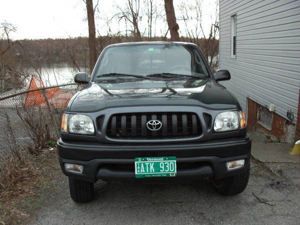

    I did the valance on my 02 and there were a lot of bolts that snapped off and had to be replaced when I put in the new valance on. I removed the lights and the worked right to left on bolt at a time till they were all out or snapped. Patience and PB Blaster are your best friends on this job LOL:)
    here is my 2002 after valance install
