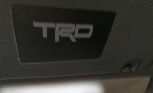

    Yeah, didn't want to go down that "removal rabbit hole" - removing the gunk from just the orig bed sticker was bad enough, layer after layer!
    Fight fire w/ fire - decal over decal. 10 min and done!
    Sorry for the blurry pic. Had to reduce the contrast in PS as it's very subtle in reality but the iPhone trying to add light in a dim vehicle just blows out the contrast.

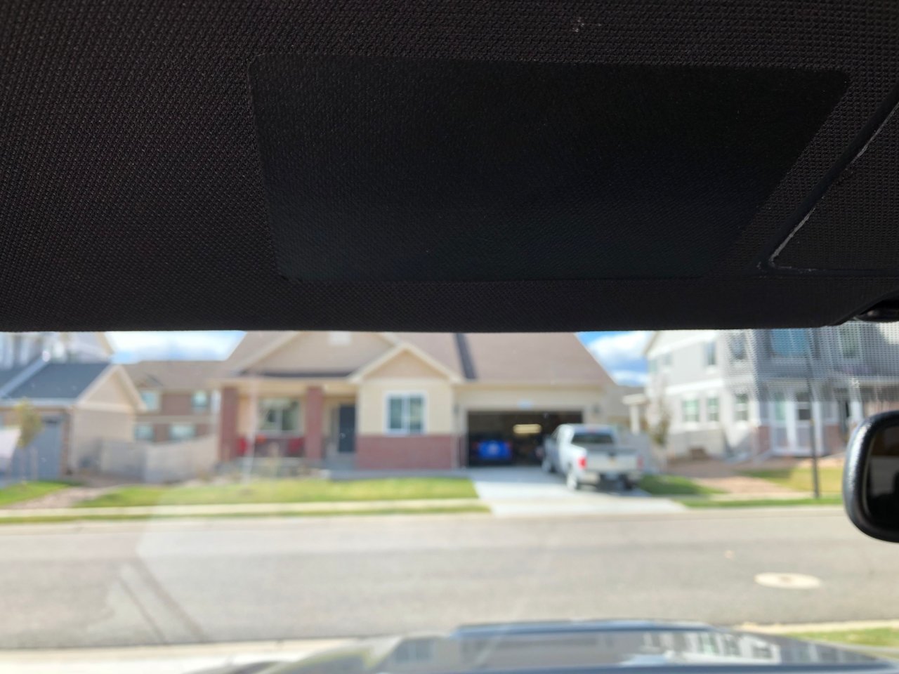

    Disclaimer, i just took it off so have not tried to clean up yet and the picture contrast is more than real life.
    I applied heat gun until a corner came loose, then I put the heat gun down and slowly pulled. It was really pulling near the end so I stopped and added more heat.
    Lesson learned - get it warm enough to start and keep some heat on it, then don’t stop pulling! Hope this will not be worse for my OCD than the sticker.

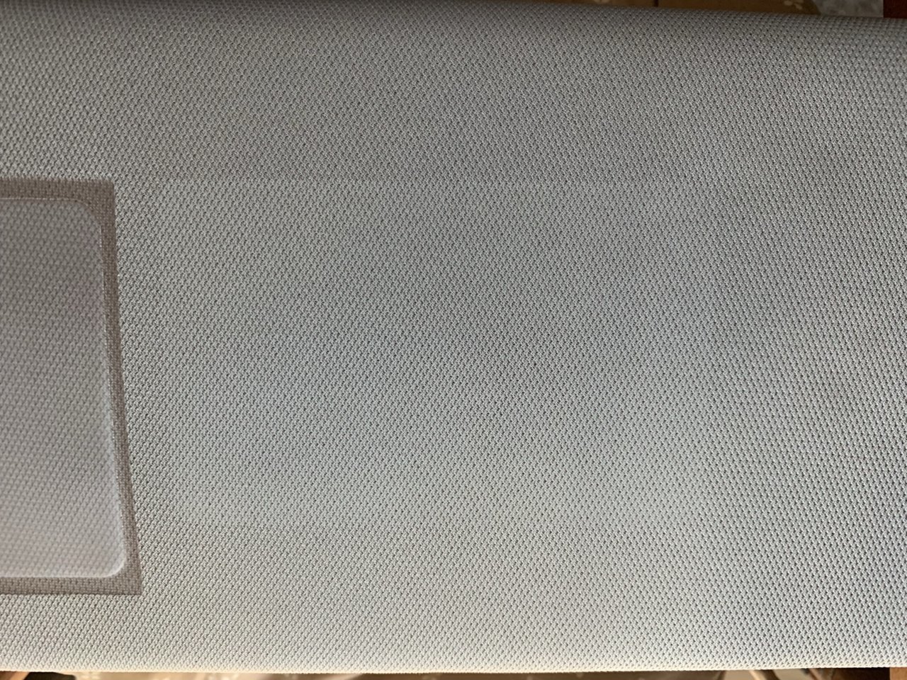

    Some stuff

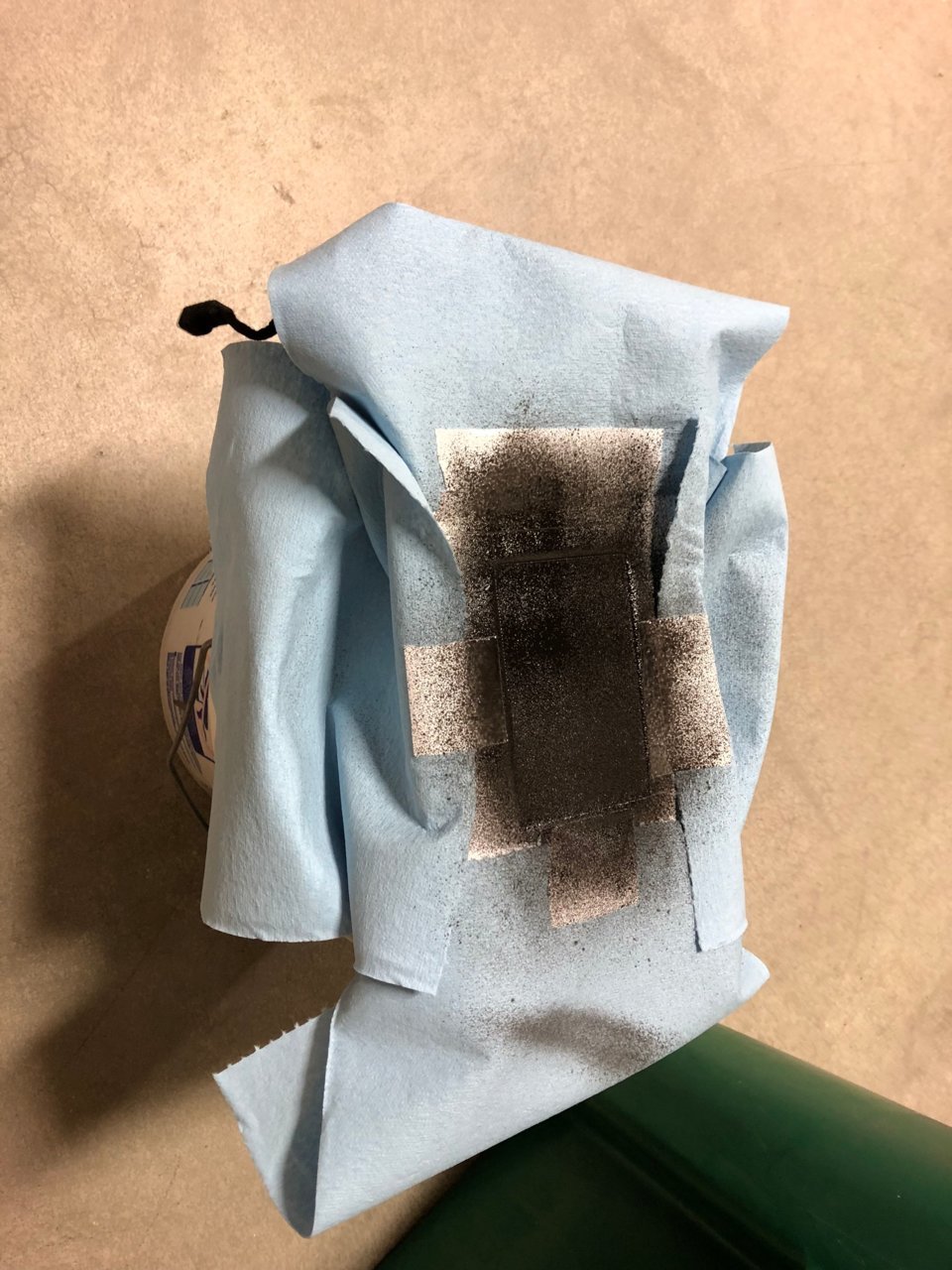

    I taped mine off and used plasti-dip. See pics below. You could then put your own sticker on after that etc. I like the minimal no sticker look as it doesn't distract from the view out the windshield.
    shiftd likes this.

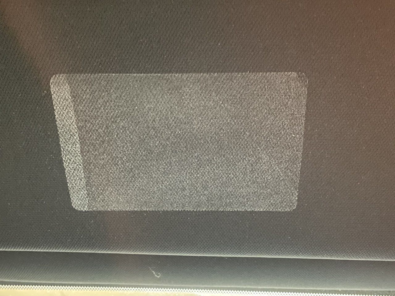

    removal of visor stickers:
    heated the visor up with a small space heater,
    worked a corner up enough to start peeling slowly,
    after sticker gone glue residue left so,
    rubbed with some 50 alcohol - got some of it but,
    put a clean piece of t shirt over spot and ironed it for 15 - 20 seconds,
    one sticker had more glue so re ironed with clean piece of shirt a couple more times till it looked good,
    did this at night and was going to get goo gone tomorrow but iron worked good,
    other side tomorrow
    spot shows more in pics than in person
