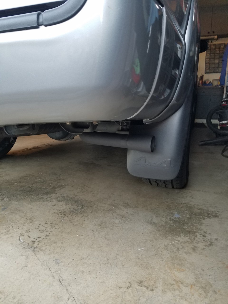

    I used 70% isopropyl alcohol. Elbow grease and time. Cleaned up with good car soap.
    I like the Brazilian look.
