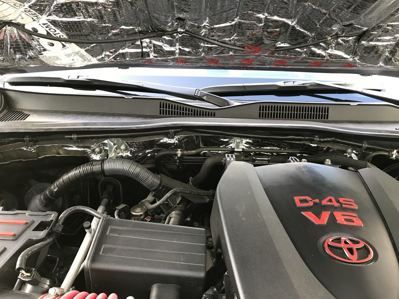

    I have had the Dynamat Hoodliner on my truck for over 2 years with no problems at all and I live in Florida where it gets very hot. The following is a quote from the 3rd gen section when I originally installed it. I have since filled in some gaps and currently have 95 square feet of Dynamat, Dynaliner, Dynapad, etc. along with 72 square feet of closed cell foam on top of all the areas where it was possible.
    Quote:
    Installed a Dynamat hood liner today. This was not to make my ride any quieter since I already have 79 square feet of Dynamat, Dynapad, etc on the doors, floor, rear wall and roof. This was primarily to block the heat from hitting the hood to protect the paint in the long term as I plan on keeping this truck a long time. A while back I noticed 10 predrilled holes in the hood frame that fit perfectly the extra box of plastic fasteners that I used for the liner under the back seats where the jack is located. Toyota apparently planned on having a hood liner come with these trucks but the bean counters cancelled it to save a few dollars. The hood liner size is 54 inches by 32 inches. The 54 inch width was perfect but the 32 inch height had to be trimmed by around 3 inches which fit well on the top of the firewall. After taking off the backing paper the liner is very sticky so I started at the middle of the hood and worked out from side to side while punching holes in for the plastic fasteners. When I got to the bottom I had to take off the tubing for the windshield washers and put them back in after pressing down the liner. Finally, after the liner was installed I sealed each side with 3M metalic duct tape. I ended up using 7 plastic fasteners which I probably didn't need since the liner was very sticky. When I took it for a test drive it did seem to be a little quieter but the main reason is still to protect the paint for the long term.
    [​IMG] [​IMG] [​IMG] [​IMG]

    Nice! Glad to see it can be done without adverse effects. I'm guessing the Dynamat hoodliner is similar to their traditional noise deadening material (butyl like Noico, Kilmat, etc) but with a higher degree of heat resistance?
