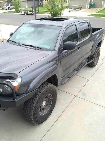

    Absolutely.
    The Frost King is legit. When I searched around the web, I read reports in corvette forums dating back (11) years ago, and they all reported that it does help reduce road noise. IMO, It will never work as good, as something like MLV to block noise... But it's cheap and works as intended as an insulation material. In fact, It would make much more sense to use a dedicated insulation material over something like Dynamat. The dynamat's and other sound deadner products, goal is to change resonance of body panels, something that the OP does not care about. It's also HEAVY, like 2/3 lb. per sq. foot! The Frost King and other products are very light weight. What makes it work is two things, 1.) It traps air, 2.) it reflects heat.
    Without getting too technical, I'd recommend Ghost Ship put the Frost King / similar insulation product in, or install a sunroof. :D
