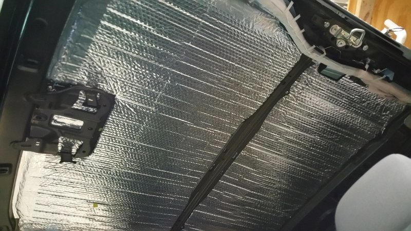

    Lowes in the insulation isle 25bucks it's foil,bubble,foil,bubble,foil I made it 3 layers thick. Cut the heat in half. image.jpg

    Is that the Frost King or anther brand?

    Well done. Looks like Reflectix insulation. Wish I had put more than one layer in when I installed. Smart to use as much as possible. :thumbsup:

    I don't know the brand it comes in two ft, and four ft. Wide Rolls.

    Sounds like Reflectix. Bummer the two Lowes' near me don't carry it. Amazon does. :thumbsup:

    Is that stuff self-adhesive or you need to use spray adhesive?

    Pressure fit. And some aluminum tape. Put the sound deadner first. Then that.
